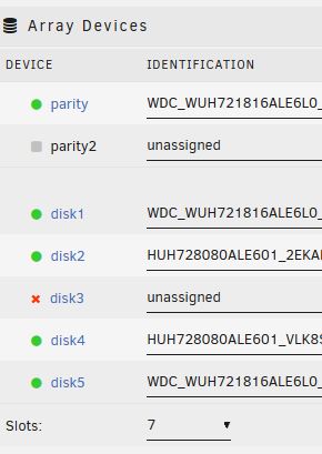

I'm upgrading an 8TB disk in my array to a larger 16TB (same size/model as my Parity Disk).  A healthy array which I have had no errors/issues with.

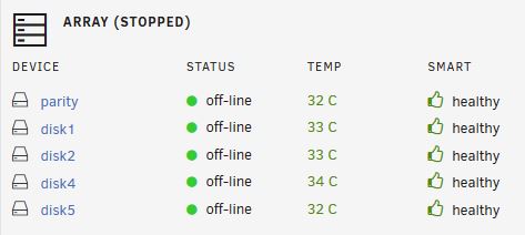

Following the documentation, I stopped the array, unassigned the disk to be replaced and restarted the array.  The Disk3 that's being replaced did not come up as emulated as expected, and even at the bottom of Main, at Array Operation, Unraid is reporting "Configuration Valid".
What is going on here, and how do I recover from this?
Currently the original 8TH is removed and 16TB is in the system.  System has been rebooted, no change.  I have a free slot to reinstall the original 8TB into the system.
I recently upgraded to 6.12.4 from 6.10.3.  I have done this upgrade before and have not seen this happen.

According to the diags emulated disk3 mounted, cannot see stats since array was then stopped.
Started array again, not showing emulated disk in Main or dashboard.  gathered this new diagnostic then stopped array.
malta-tower-diagnostics-20231009-0920.zip
Disk is being correctly emulated:
Filesystem      Size  Used Avail Use% Mounted on
/dev/md3p1      7.3T  4.3T  3.1T  59% /mnt/disk3
You will see the used/free space on the main GUI page, just need to assign the new disk to rebuild.
I assigned the new 16TB drive and restarted the array.  Now Unraid is reporting an emulated drive and is rebuilding it on the new 16TB drive.
