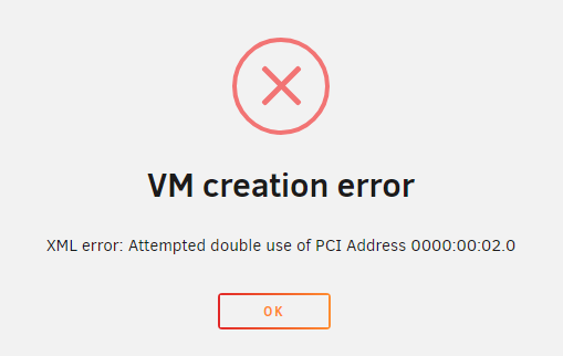

I had an OVMF TPM setup for Windows 11 on my 6.11.5 UNRAID server. It suddenly went into a UEFI loop and recommendations on the forum said to try SeaBIOS to stop this issue occurring. After re-creating with SeaBIOS though I get an error trying to switch from VNC to iGPU. Any ideas why?

It will be because this device is using the values that the iGPU needs when they are allocated by libvirt.
    <controller type='pci' index='1' model='pcie-root-port'>
      <model name='pcie-root-port'/>
      <target chassis='1' port='0x10'/>
      <address type='pci' domain='0x0000' bus='0x00' slot='0x02' function='0x0' multifunction='on'/>
    </controller>
You would need to do a manual edit of the XML or you can try just delete the vm xml and recreating from the gui.

I am not sure what I should edit it to or how I would delete the XML sorry

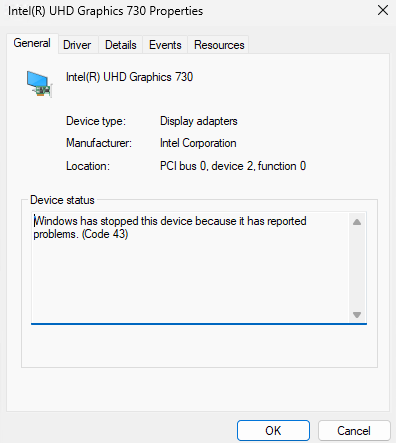

I managed to get the iGPU to attach to the VM but even after installing the latest drivers inside Windows 11 the Display Adapter is failing with error code 43
