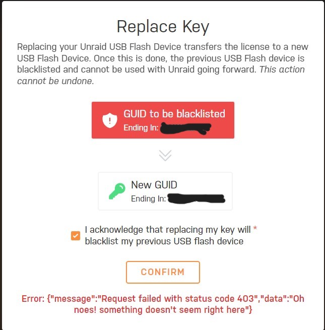

I followed the manual: made a backup to my Win10 PC via the WebGUI, then used USB Flash Creator with the zip backup to make a new unRAID flash drive. Then I shutdown the server and replaced the original flash drive with the new one. After restarting the server I got the expected message about the registration key and navigated to the Replace Key button (manual is a bit out of date here) and selected it.
Then I got the following error message after clicking confirm in this window:
What do I do now?

I would suggest you contact support giving them the details.   They tend to be quite responsive.

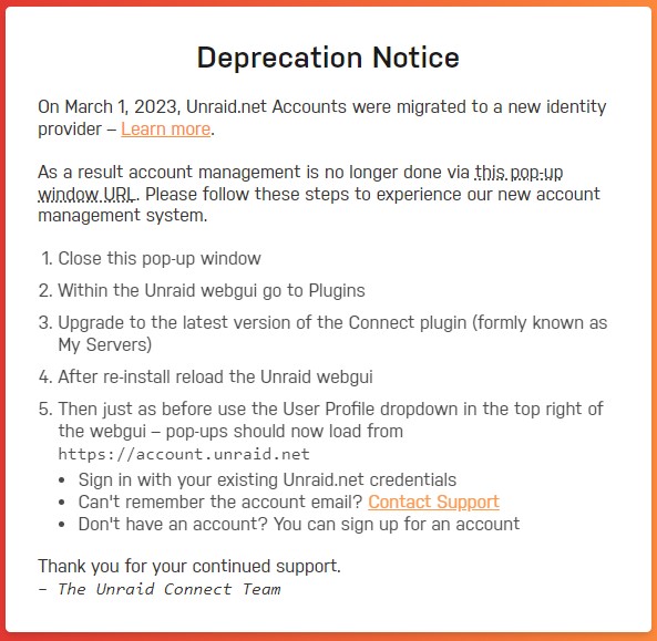

I did have a bit of a connection issue because the manual (https://docs.unraid.net/unraid-os/manual/changing-the-flash-device/) doesn't mention unRAID Connect, which I didn't realise is more or less mandatory now and hadn't installed. Then I had a problem because I had three unRAID entries in my authorisation app from the time the unRAID.net accounts were re-done. Eventually got there, and it wasn't too difficult.

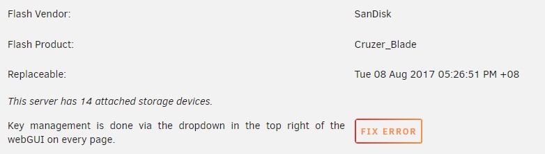

2. I had previously installed Unraid Connect in order to get to the Replace Key process, but it didn't show up during this replacement process, and I had to install it again. Previously I had logged on to Unraid.net via Unraid Connect, but I didn't "sign up" for Management Access. It looks like when I rebooted, perhaps because of not signing up, Unraid Connect didn't "stick" so the server acted as if Unraid Connect wasn't there. This causes various problems for the unsuspecting (I'm on 6.11.5):

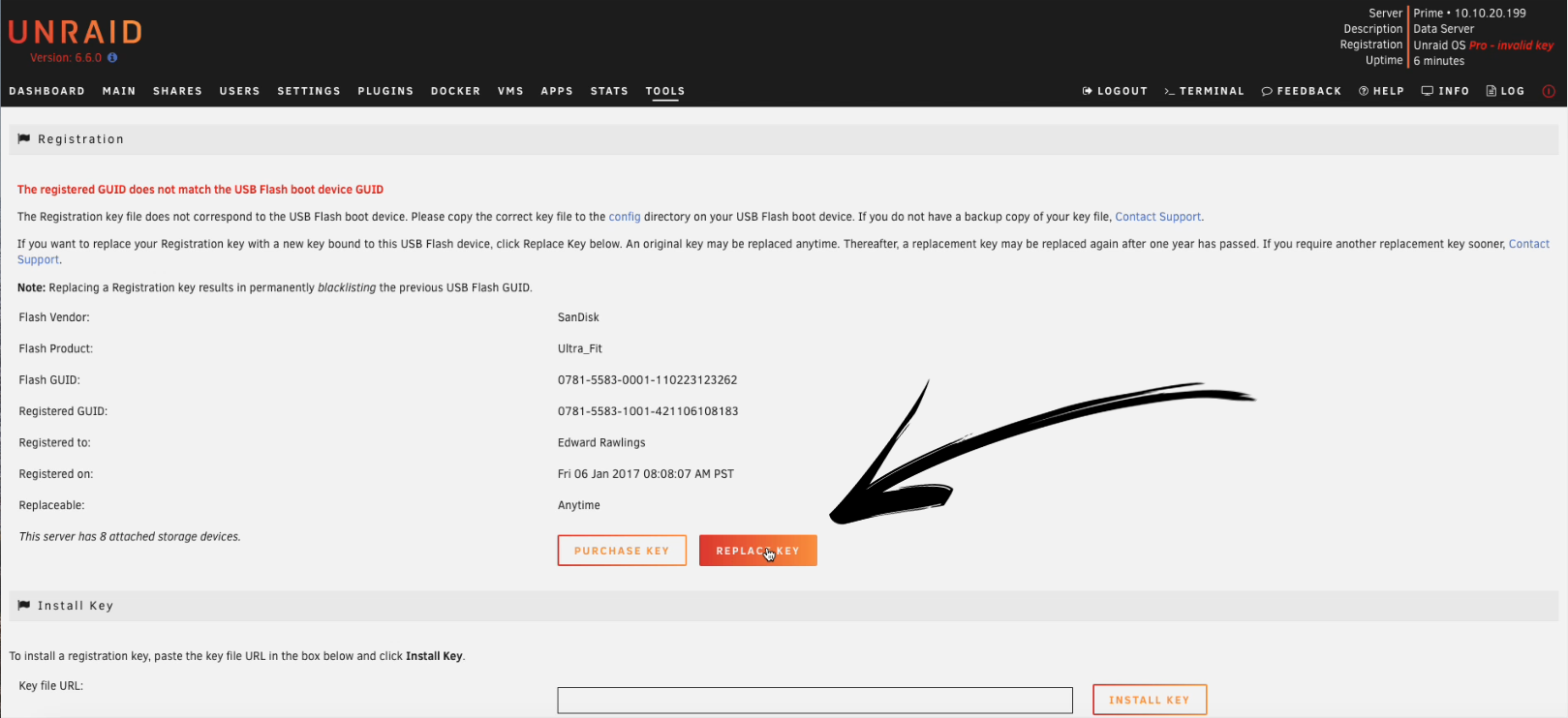

If I click on the Registration Key link as shown in the manual I don't get the screen below (from the manual):
Replacekey-6ba2def31bd3519f5702d9a06a9441a3.thumb.png.a41e723c8297cad13f4e519248afadb3.png

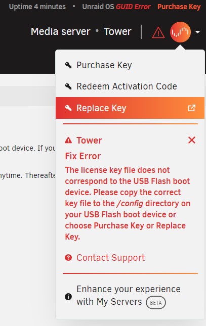

Instead I get:
When I go to the to right I see:
When I click on Replace Key I get a pop-up:
So this eventually got me to the right place, but setting this out here for anyone who doesn't have Unraid Connect.
