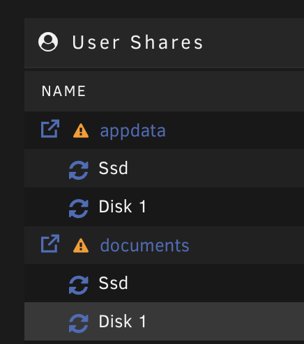

Thank you Jorge,
Procedure done. Now I see system which is totally on SSD, but have a warning symbol telling me "Some or all file are unprotected".
Also "appdata" and another share of mine have the same warning. They're on SSD with some bytes left on Array, how can i delete that?
What does that warning mean? If it mean the files are only on the single cache SSD i'm okay with that, how can i disable that?

It means that but there's no way to disable the warning, you can just ignore.

Another question: I see two shares which have some bytes left on Disk 1. How can I remove residual data from disk 1?
You need to see why the data is not being moved by the mover, enable the mover logging and run the mover, if there a duplicate files you will need to decide which to keep, usually delete the older ones.
I noted there was only the empty folder left on "disk1", deleted it and now everything seem ok!
