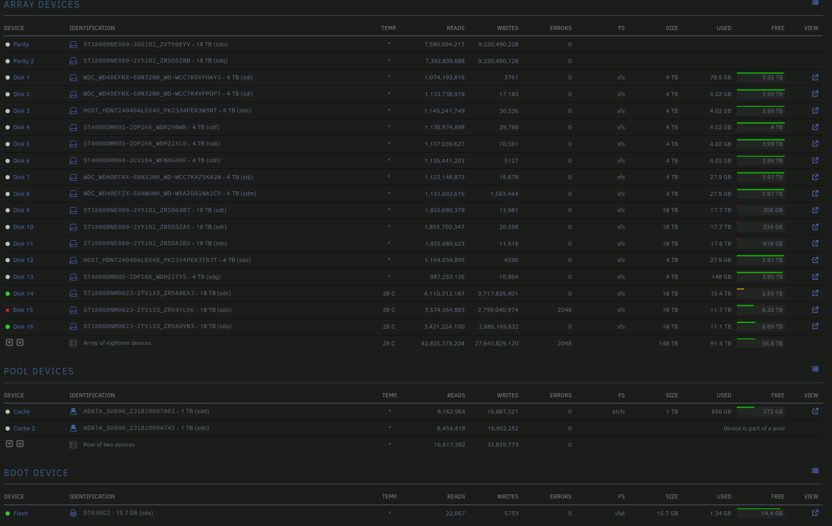

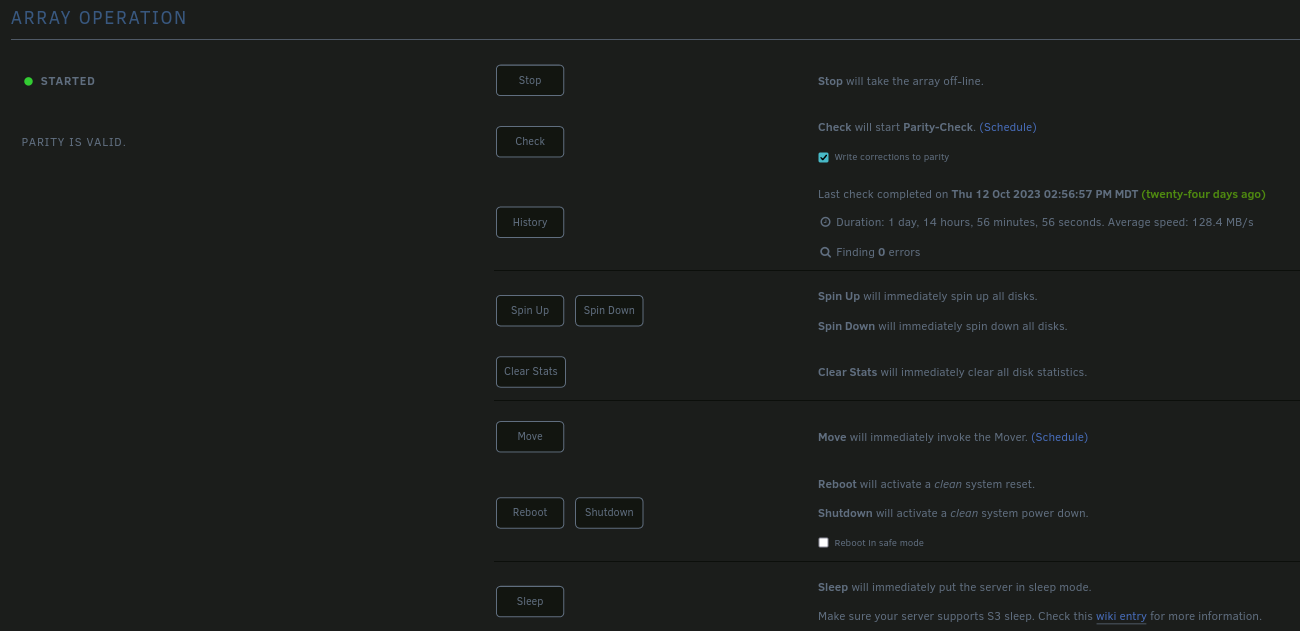

JorgeB, apologies your help has been appreciated but while I understand what you have advised I am not sure of the steps to take.
I know that normally with a failed drive if I take it out and then put in a new drive, I can rebuild the array. How would it work in this situation? Do I force the system to start a rebuild or do I take the drive out and start the rebuild? Would the array rebuild onto the 4 TB drives that are still in shape?
Attached are screenshots of how my "Main" tab is looking for the drives and array options.
A side note when I clicked on the little icon next to the drive it pulled up Logs? and I have the following showing in it for the drive that is disabled
