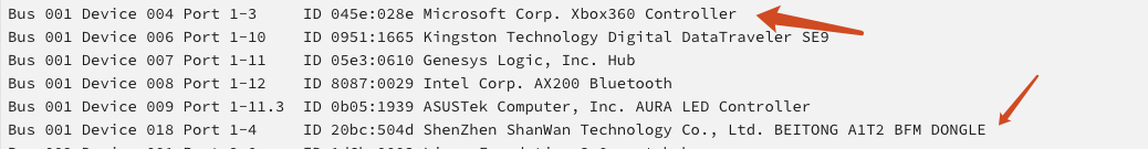

Yesterday, I only connected one USB controller, selected it in the Windows virtual machine, and then started it up. Today, when I returned home, I found that this game controller had been recognized as an Xbox controller and was working fine. At this point, I connected another controller to Unraid, selected it in Windows, and started it up, but the other controller still showed as ID 20bc:504d ShenZhen ShanWan Technology Co., Ltd. BEITONG A1T2 BFM DONGLE, and couldn't function properly.
After disconnecting and reconnecting both controllers, they reverted to their original state, both displaying as ID 20bc:504d ShenZhen ShanWan Technology Co., Ltd. BEITONG A1T2 BFM DONGLE. Just now, I connected one game controller first, then selected it in Windows and started it up, and then connected the second controller.
That's the complete situation. It seems that if the game controller is recognized as an Xbox controller, it works properly. But how can I make both game controllers recognized as Xbox controllers? Is it possible that after connecting the game controller to Unraid, it needs some time to automatically identify as an Xbox controller before it can work properly?

update:
