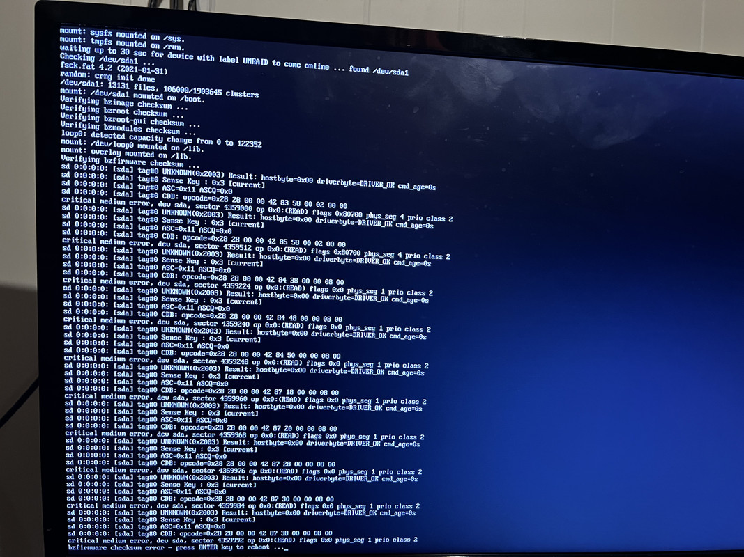

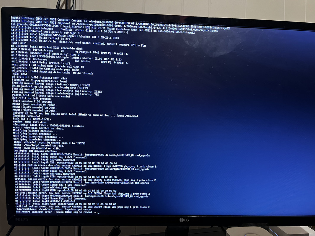

Today I had an issue booting into Unraid, I am getting the following error when attempting to boot into Unraid 6.12.4. If this is a flash drive failure, it is the second one in 6 months. I will need to contact unraid support and get the drive deactivated so I can register a new one, correct? I have a higher quality replacement flash drive prepared.
I can mount the flash drive in macOS without issue, but I do not have access to a flash backup via unraid connect. Please advise on the most seamless way to get this flash drive swapped with my original config files.
Solved by JorgeB
It does look like a flash problem, see if you can copy the /config folder.
