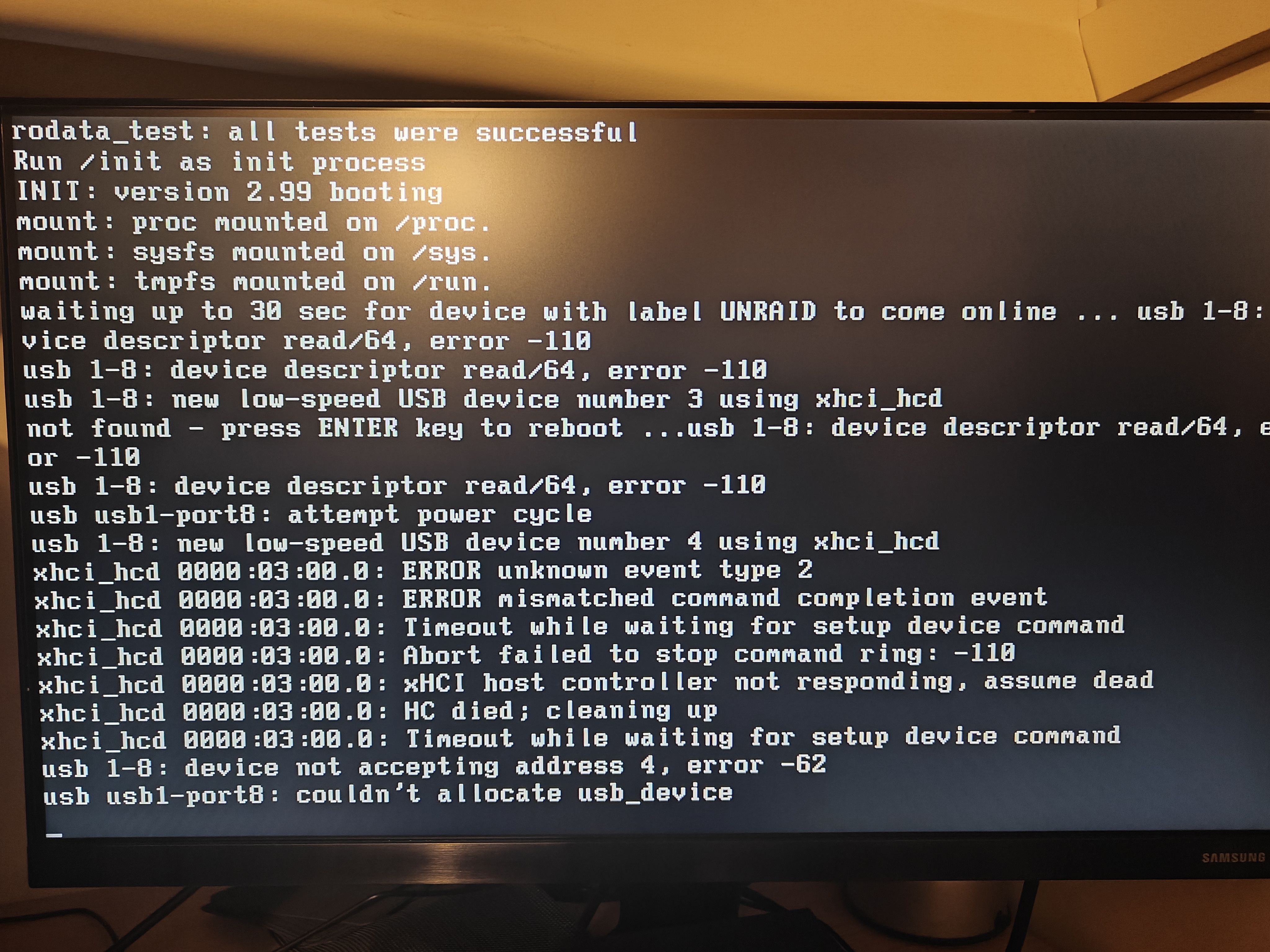

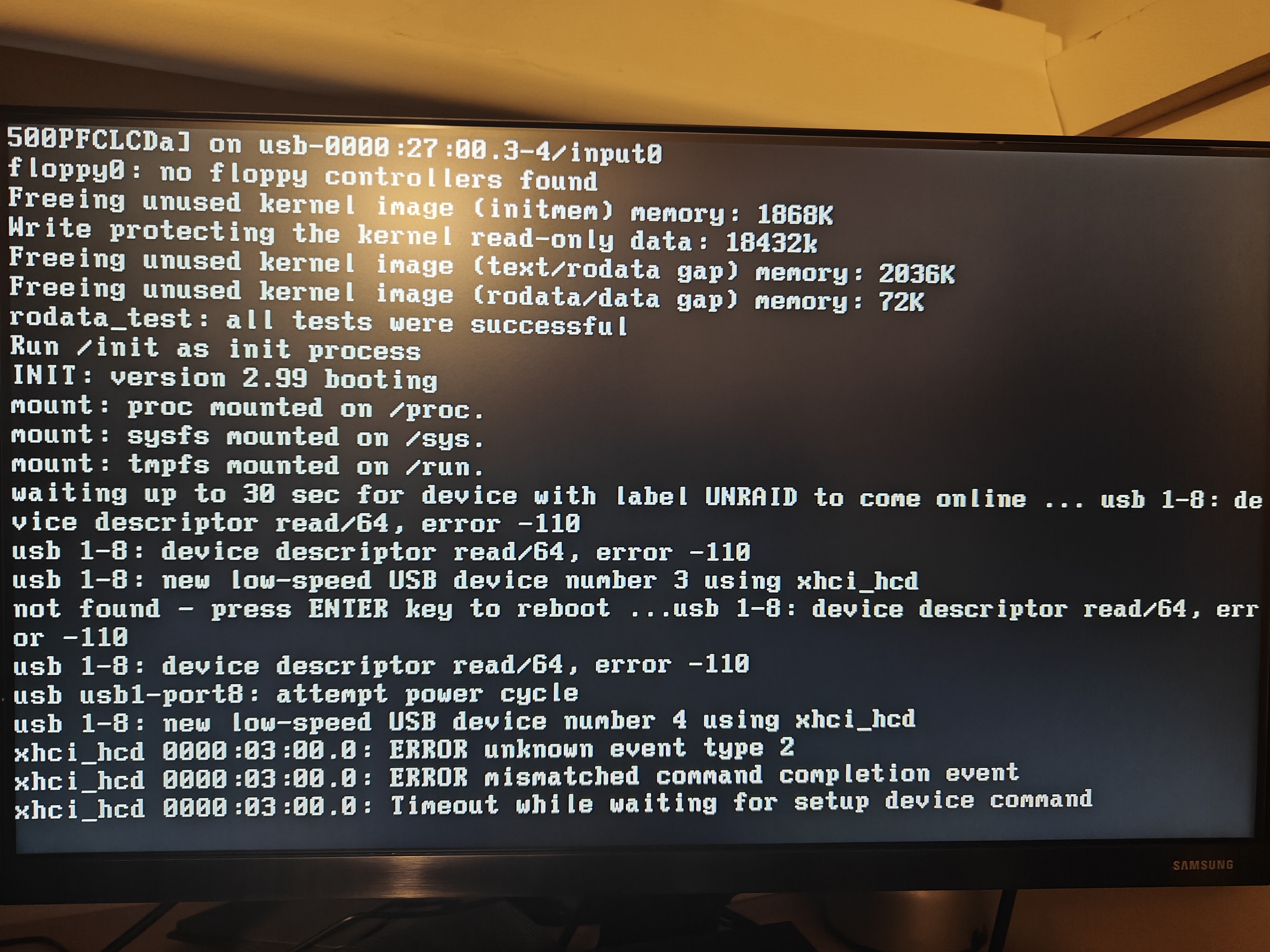

So this time when the server went unresponsive it actually gave some errors on the attached monitor
Looks like the usb drive might be failing? in which case I do have a spare I can try to transfer this one to.
Added syslog just in case too.
syslog_12_3_23
Could be, but looks unrelated to the crashing, unfortunately there's nothing relevant logged, suggesting a possible hardware issue.
