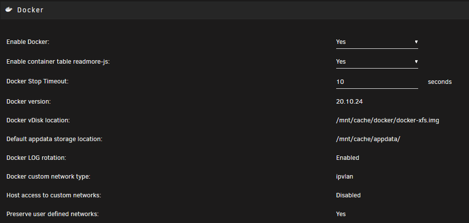

Here some updates better known as "what I have now done to further track down the issue":
- Changed macvlan to ipvlan
Just in case, because some ppl report problems and unresponsive systems
When was this done and did you reboot after changing?
Dec  3 08:37:06 Anubis kernel: macvlan_broadcast+0x10a/0x150 [macvlan]
Dec  3 08:37:06 Anubis kernel: ? _raw_spin_unlock+0x14/0x29
Dec  3 08:37:06 Anubis kernel: macvlan_process_broadcast+0xbc/0x12f [macvlan]
These are recent
WHEN:
iirc after that because of some threads I found.
DID YOU REBOOT
Yes because machine stopped again after that change.
You should not be getting macvlan call traces with ipvlan, post the output of:
docker network ls
docker network ls
NETWORK ID     NAME         DRIVER    SCOPE
3d24d0daa2b1   br0          ipvlan    local
e736a7064171   bridge       bridge    local
d8b2bb19546c   mynet        bridge    local
fba54f09fdbb   host         host      local
1c7e099ecfb9   none         null      local
Current update is 17h - and parity check started (currently 7x%.
I am not entirely sure, but I think somewhere close to the end of the parity check the system went into unresponsive state, so fingers crossed I will update this post asap.
Still :) thank you for your help JorgeB.

Can be closed. So it was maybe macvlan change to ipvlan. Or the IOMMU change.
But I would bet on macvlan to ipvlan change right now - NIC is iirc a broadcom NetXtreme BCM5720NIC.
Just as reference if anybody maybe expierence same issues.
