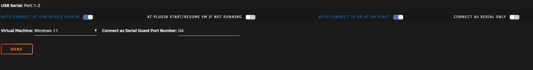

If you use my USB Manager plugin it will reconnect the USB when you switch. You need to remove from the VM template and setup USBM.
You can create a mapping either as a port or device. Enable Auto connect at device plugin and at VM Start.
Not sure why your BT is not working.

That sure fixed the issue with my KVM.  Changing to usb 3 didn't do anything for my bluetooth issue though.

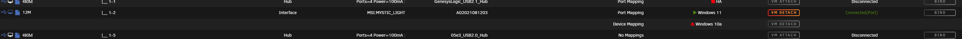

That was it.  As for the USB, its still changing IDs each time I switch on the KVM.  So I'm going to just add each of them as they pop up.  It actually seems like its cycling through 5 of them.  Some chinese garbage Im sure.

The plugin should be able to handle changing Ids
can you provide cat /var/log/syslog | grep usb_manager
and cat /var/local/emhttp/state/usb.ini
no such file for usb.ini

Dec  4 17:19:15 Tower usb_manager: Info: virsh called Windows 11 001 017 Device attached successfully
Dec  4 17:19:15 Tower usb_manager: Info: rc.usb_manager Autoconnect Start 001/017 temp vm: Windows 11
Dec  4 17:19:15 Tower usb_manager: Info: virsh called Windows 11 001 012 Device attached successfully
Dec  4 17:19:15 Tower usb_manager: Info: rc.usb_manager Autoconnect Start 001/012 temp vm: Windows 11
Dec  4 17:19:52 Tower usb_manager: Info: rc.usb_manager Add device with more than one interface & connect serial   .
Dec  4 17:19:52 Tower usb_manager: Info: rc.usb_manager Autoconnect No Mapping found 1101_2222 /dev/bus/usb/003/013 003 013 port 3-1.1
Dec  4 17:24:20 Tower usb_manager: Info: rc.usb_manager  vm_action Windows 11 stopped end -
Dec  4 17:24:20 Tower usb_manager: Info: rc.usb_manager VM Shutdown 001/012 vm: Windows 11
Dec  4 17:24:20 Tower usb_manager: Info: rc.usb_manager VM Shutdown 001/016 vm: Windows 11
Dec  4 17:24:20 Tower usb_manager: Info: rc.usb_manager VM Shutdown 001/017 vm: Windows 11
Dec  4 17:24:50 Tower usb_manager: Info: rc.usb_manager  vm_action Windows 11 prepare begin -
Dec  4 17:24:53 Tower usb_manager: Info: virsh called Windows 11 001 016 Device attached successfully
Dec  4 17:24:53 Tower usb_manager: Info: rc.usb_manager Autoconnect Start 001/016 temp vm: Windows 11
Dec  4 17:24:54 Tower usb_manager: Info: virsh called Windows 11 001 017 Device attached successfully
Dec  4 17:24:54 Tower usb_manager: Info: rc.usb_manager Autoconnect Start 001/017 temp vm: Windows 11
Dec  4 17:24:54 Tower usb_manager: Info: virsh called Windows 11 001 012 Device attached successfully
Dec  4 17:24:54 Tower usb_manager: Info: rc.usb_manager Autoconnect Start 001/012 temp vm: Windows 11
Dec  4 17:24:54 Tower usb_manager: Info: virsh called Windows 11 003 013 Device attached successfully
Dec  4 17:24:54 Tower usb_manager: Info: rc.usb_manager Autoconnect Start 003/013 temp vm: Windows 11
Dec  4 17:25:04 Tower usb_manager: Info: rc.usb_manager usb_remove  1101_2222 /dev/bus/usb/003/013 003 013
Dec  4 17:25:04 Tower usb_manager: Info: rc.usb_manager Device Match 003/013 vm: Windows 11  003 013
Dec  4 17:25:05 Tower usb_manager: Info: virsh called Windows 11 003 013 Device detached successfully
Dec  4 17:25:05 Tower usb_manager: Info: rc.usb_manager Disconnect  003/013 vm: Windows 11 running 003 013
Dec  4 17:25:05 Tower usb_manager: Info: rc.usb_manager Removed 003/013 vm: Windows 11 running 003 013
Dec  4 17:25:05 Tower usb_manager: Info: rc.usb_manager usb_add 1100_2222 /dev/bus/usb/003/014 003 014
Dec  4 17:25:58 Tower usb_manager: Info: rc.usb_manager Add device with more than one interface & connect serial   .
Dec  4 17:25:58 Tower usb_manager: Info: rc.usb_manager Autoconnect vm state:running 1100_2222 running 003 014
Dec  4 17:25:58 Tower usb_manager: Info: virsh called Windows 11 003 014 Device attached successfully
Dec  4 17:26:56 Tower usb_manager: Info: rc.usb_manager  vm_action Windows 11 stopped end -
Dec  4 17:26:56 Tower usb_manager: Info: rc.usb_manager VM Shutdown 001/012 vm: Windows 11
Dec  4 17:26:56 Tower usb_manager: Info: rc.usb_manager VM Shutdown 001/016 vm: Windows 11
Dec  4 17:26:56 Tower usb_manager: Info: rc.usb_manager VM Shutdown 001/017 vm: Windows 11
Dec  4 17:26:56 Tower usb_manager: Info: rc.usb_manager VM Shutdown 003/014 vm: Windows 11
Dec  4 17:28:09 Tower usb_manager: Info: rc.usb_manager  vm_action Windows 11 prepare begin -
Dec  4 17:28:12 Tower usb_manager: Info: virsh called Windows 11 003 014 Device attached successfully
Dec  4 17:28:12 Tower usb_manager: Info: rc.usb_manager Autoconnect Start 003/014 temp vm: Windows 11
Dec  4 17:28:12 Tower usb_manager: Info: virsh called Windows 11 001 016 Device attached successfully
Dec  4 17:28:12 Tower usb_manager: Info: rc.usb_manager Autoconnect Start 001/016 temp vm: Windows 11
Dec  4 17:28:12 Tower usb_manager: Info: virsh called Windows 11 001 017 Device attached successfully
Dec  4 17:28:12 Tower usb_manager: Info: rc.usb_manager Autoconnect Start 001/017 temp vm: Windows 11
Dec  4 17:28:13 Tower usb_manager: Info: virsh called Windows 11 001 012 Device attached successfully
Dec  4 17:28:13 Tower usb_manager: Info: rc.usb_manager Autoconnect Start 001/012 temp vm: Windows 11
Dec  4 17:29:59 Tower usb_manager: Info: rc.usb_manager usb_remove  Broadcom_Corp_BCM2045A_0002720B18F2 /dev/bus/usb/001/012 001 012
Dec  4 17:29:59 Tower usb_manager: Info: rc.usb_manager Device Match 001/012 vm: Windows 11  001 012
Dec  4 17:29:59 Tower usb_manager: Info: virsh called Windows 11 001 012 Device detached successfully
Dec  4 17:29:59 Tower usb_manager: Info: rc.usb_manager Disconnect  001/012 vm: Windows 11 running 001 012
Dec  4 17:29:59 Tower usb_manager: Info: rc.usb_manager Removed 001/012 vm: Windows 11 running 001 012
Dec  4 17:43:46 Tower usb_manager: Info: rc.usb_manager usb_remove  8BitDo_IDLE_E417D8F8FA8C /dev/bus/usb/001/016 001 016
Dec  4 17:43:46 Tower usb_manager: Info: rc.usb_manager Device Match 001/016 vm: Windows 11  001 016
Dec  4 17:43:46 Tower usb_manager: Info: virsh called Windows 11 001 016 Device detached successfully
Dec  4 17:43:46 Tower usb_manager: Info: rc.usb_manager Disconnect  001/016 vm: Windows 11 running 001 016
Dec  4 17:43:46 Tower usb_manager: Info: rc.usb_manager Removed 001/016 vm: Windows 11 running 001 016
Dec  4 17:43:47 Tower usb_manager: Info: rc.usb_manager usb_add 8BitDo_8BitDo_Ultimate_wireless_Controller_for_PC_E417D8F8FA8C /dev/bus/usb/001/018 001 018
Dec  4 17:44:22 Tower usb_manager: Info: rc.usb_manager usb_add 8BitDo_IDLE_E417D8F8FA8C /dev/bus/usb/001/022 001 022
Dec  4 17:45:12 Tower usb_manager: Info: rc.usb_manager Autoconnect No Mapping found 8BitDo_8BitDo_Ultimate_wireless_Controller_for_PC_E417D8F8FA8C /dev/bus/usb/001/018 001 018 port
Dec  4 17:45:12 Tower usb_manager: Info: rc.usb_manager usb_add  /dev/bus/usb/001/019 001 019
Dec  4 17:45:12 Tower usb_manager: Info: rc.usb_manager usb_remove  8BitDo_8BitDo_Ultimate_wireless_Controller_for_PC_E417D8F8FA8C /dev/bus/usb/001/018 001 018
Dec  4 17:45:29 Tower usb_manager: Info: rc.usb_manager Autoconnect vm state:running 8BitDo_IDLE_E417D8F8FA8C running 001 022
Dec  4 17:45:29 Tower usb_manager: Info: virsh called Windows 11 001 022 Device attached successfully
Dec  4 17:46:02 Tower usb_manager: Info: rc.usb_manager Autoconnect No Mapping found  /dev/bus/usb/001/019 001 019 port
Dec  4 17:46:02 Tower usb_manager: Info: rc.usb_manager usb_remove   /dev/bus/usb/001/019 001 019
Dec  4 17:46:02 Tower usb_manager: Info: rc.usb_manager usb_add  /dev/bus/usb/001/020 001 020
Dec  4 17:46:43 Tower usb_manager: Info: rc.usb_manager Autoconnect No Mapping found  /dev/bus/usb/001/020 001 020 port
Dec  4 17:46:43 Tower usb_manager: Info: rc.usb_manager usb_add  /dev/bus/usb/001/021 001 021
Dec  4 17:46:43 Tower usb_manager: Info: rc.usb_manager usb_remove   /dev/bus/usb/001/020 001 020
Dec  4 17:47:24 Tower usb_manager: Info: rc.usb_manager Autoconnect No Mapping found  /dev/bus/usb/001/021 001 021 port
Dec  4 17:47:24 Tower usb_manager: Info: rc.usb_manager usb_remove   /dev/bus/usb/001/021 001 021
Dec  4 17:47:24 Tower usb_manager: Info: rc.usb_manager usb_add 8BitDo_8BitDo_Ultimate_wireless_Controller_for_PC_E417D8F8FA8C /dev/bus/usb/001/023 001 023
Dec  4 17:47:24 Tower usb_manager: Info: rc.usb_manager usb_remove  8BitDo_IDLE_E417D8F8FA8C /dev/bus/usb/001/022 001 022
Dec  4 17:47:24 Tower usb_manager: Info: rc.usb_manager Device Match 001/022 vm: Windows 11  001 022
Dec  4 17:47:24 Tower usb_manager: Info: virsh called Windows 11 001 022 Device detached successfully
Dec  4 17:47:24 Tower usb_manager: Info: rc.usb_manager Disconnect  001/022 vm: Windows 11 running 001 022
Dec  4 17:47:24 Tower usb_manager: Info: rc.usb_manager Removed 001/022 vm: Windows 11 running 001 022
Dec  4 17:48:18 Tower usb_manager: Info: rc.usb_manager  vm_action Windows 11 stopped end -
Dec  4 17:48:18 Tower usb_manager: Info: rc.usb_manager VM Shutdown 001/017 vm: Windows 11
Dec  4 17:48:18 Tower usb_manager: Info: rc.usb_manager VM Shutdown 003/014 vm: Windows 11
Dec  4 17:48:21 Tower usb_manager: Info: rc.usb_manager Autoconnect No Mapping found 8BitDo_8BitDo_Ultimate_wireless_Controller_for_PC_E417D8F8FA8C /dev/bus/usb/001/023 001 023 port
Dec  4 17:48:21 Tower usb_manager: Info: rc.usb_manager usb_add 8BitDo_IDLE_E417D8F8FA8C /dev/bus/usb/001/024 001 024
Dec  4 17:48:21 Tower usb_manager: Info: rc.usb_manager usb_remove  8BitDo_8BitDo_Ultimate_wireless_Controller_for_PC_E417D8F8FA8C /dev/bus/usb/001/023 001 023
Dec  4 17:48:21 Tower usb_manager: Info: rc.usb_manager starting/resuming vm as device connected Windows 11 device map from state shutoff.
Dec  4 17:48:22 Tower usb_manager: Info: rc.usb_manager  vm_action Windows 11 prepare begin -
Dec  4 17:48:25 Tower usb_manager: Info: virsh called Windows 11 003 014 Device attached successfully
Dec  4 17:48:25 Tower usb_manager: Info: rc.usb_manager Autoconnect Start 003/014 temp vm: Windows 11
Dec  4 17:48:25 Tower usb_manager: Info: virsh called Windows 11 001 017 Device attached successfully
Dec  4 17:48:25 Tower usb_manager: Info: rc.usb_manager Autoconnect Start 001/017 temp vm: Windows 11
Dec  4 17:48:31 Tower usb_manager: Info: Removing configuration '8BitDo_IDLE_E417D8F8FA8C'.

I would set that as a port mapping for the 8bit device rather than name. But looks like it will still disconnect will see if I can find more info about it.
I would also turn off Start/Resume just leave auto connect and on VM Start turned on for the devices unless you want it to start the VM.

So I did the port instead and it will not show up in the VM unless I stop and start the VM.
Not sure why this one thing is being so odd with USB.
