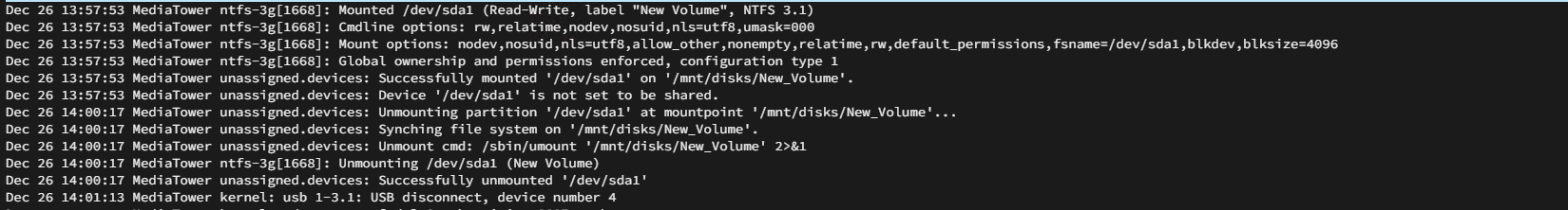

I just finished upgrading from 6.11 --> 6.12.6 and have UD 2023.12.15 Plugin.
Everything is good with one exception.  I have an unassigned device, it's a portable hard drive connected to the Server's USB Port.
This is the volume before the upgrade:  image.png.c5feb88e664423aa9eecefd40468d618.png
This is the volume after the upgrade:  image.png.9d404134dc05079c3e3bd6ced50128b6.png
It will mount but I cannot access the share.  I took the drive an plugged in into my laptop's USB Port, I am able to view the contents without issue.
Is there anything I should be looking at? "New_Volume" is the name of share.

Are you trying to access the data locally on the server or across the network?  If the latter you need to set it to be shared.
I removed the drive from historical devices.  Plugged it back in and set the Mount Share=Yes.   It shows up correctly and I can access the drive.
