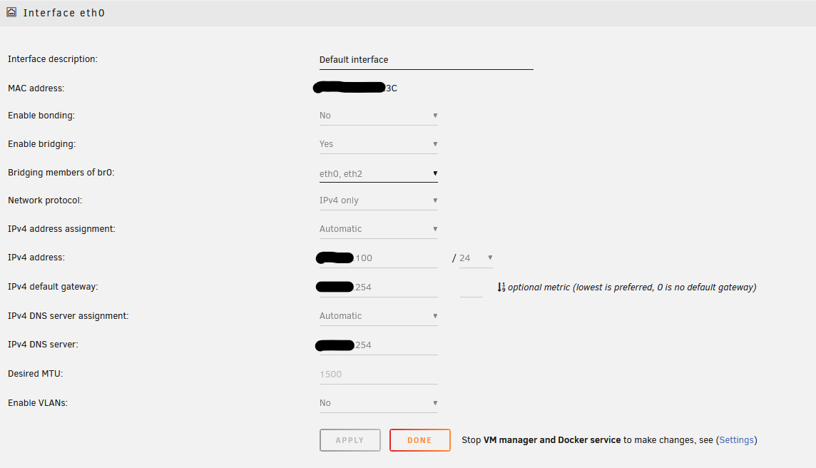

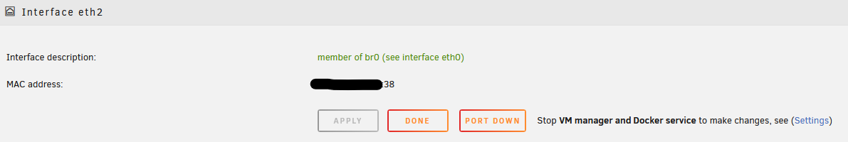

I don't know exactly why this is, but it might be because I configured my SFP+ port recently and I might not have done it correctly. I tried first plugging in only my SFP+ port, but then my server had no connection. So, I plugged my Ethernet cable back in and then I had a connection again. I watched the video by Spaceinvador One where he configures a 1 gig port and a 10 gig port separately, which I'm not the biggest fan of. I would rather just have one IP pointing to my server and access everything through it. So, after tinkering a bit, I found this configuration that achieved what I wanted. It's been working fine until now, but it might be causing some issues.
This is the config:
eth0 is the 1gig port
And eth2 is the 10gig connection

I'm indeed not using it, where can I disable it? I can't find a setting to edit that here: Settings > NetworkSettings
I do have this selected:
Edited by Alpha.Ars
add network protocol selection
That should only use ipv4, check also docker networks.

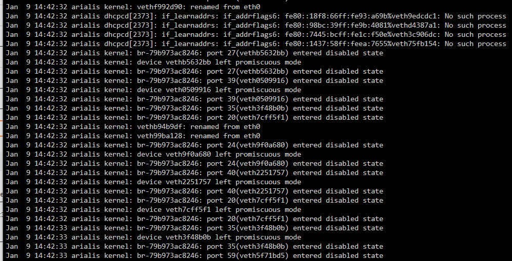

Yep the containers are indeed the problem here, pterodactyl includes ipv6 now, I'm looking how to disable this
I'm a little lost I noticed one of my docker containers was causing the issue, and ... I think I fixed it but I'm not sure.
I still have the issue, Is there any way to know what containers  are causing the problem ?
I'm not sure what I'm supposed to look into or what I should do. This is still getting spammed:image.png.9d4d4539e2e1bde964cd36c93a569f9e.png
And I'm not sure this would lead to anything but when I use the 'dhcpcd' command it shows info, and like 15 sec later the server just goes down and or is not reachable anymore.
