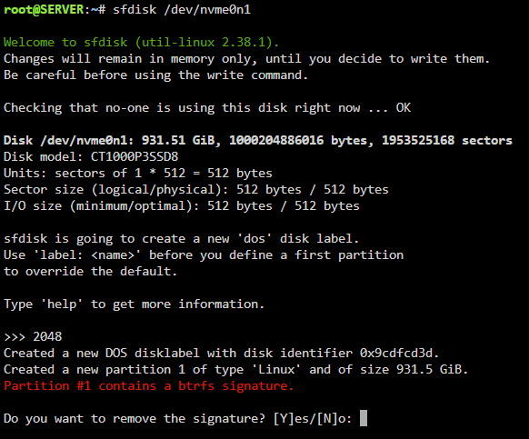

There is no partition on the NVMe device, suggesting the device was wiped, the other one is likely the same, a forced reboot should never cause that, post the output of:
sfdisk /dev/nvme0n1
then type
2048
and hit return and post a screenshot of the results
Type N to KEEP the signature, hit return, then type
write
and hit return again, do the same for the other nvme device (nvme1n1) and then post the output of
btrfs fi show
P.S. I may only be able to reply tomorrow, so you can also try re-starting the array to see if the pool mounts, it won't damaged anything if it doesn't, if you just re-start it as is, and post new diags if it still doesn't mount
