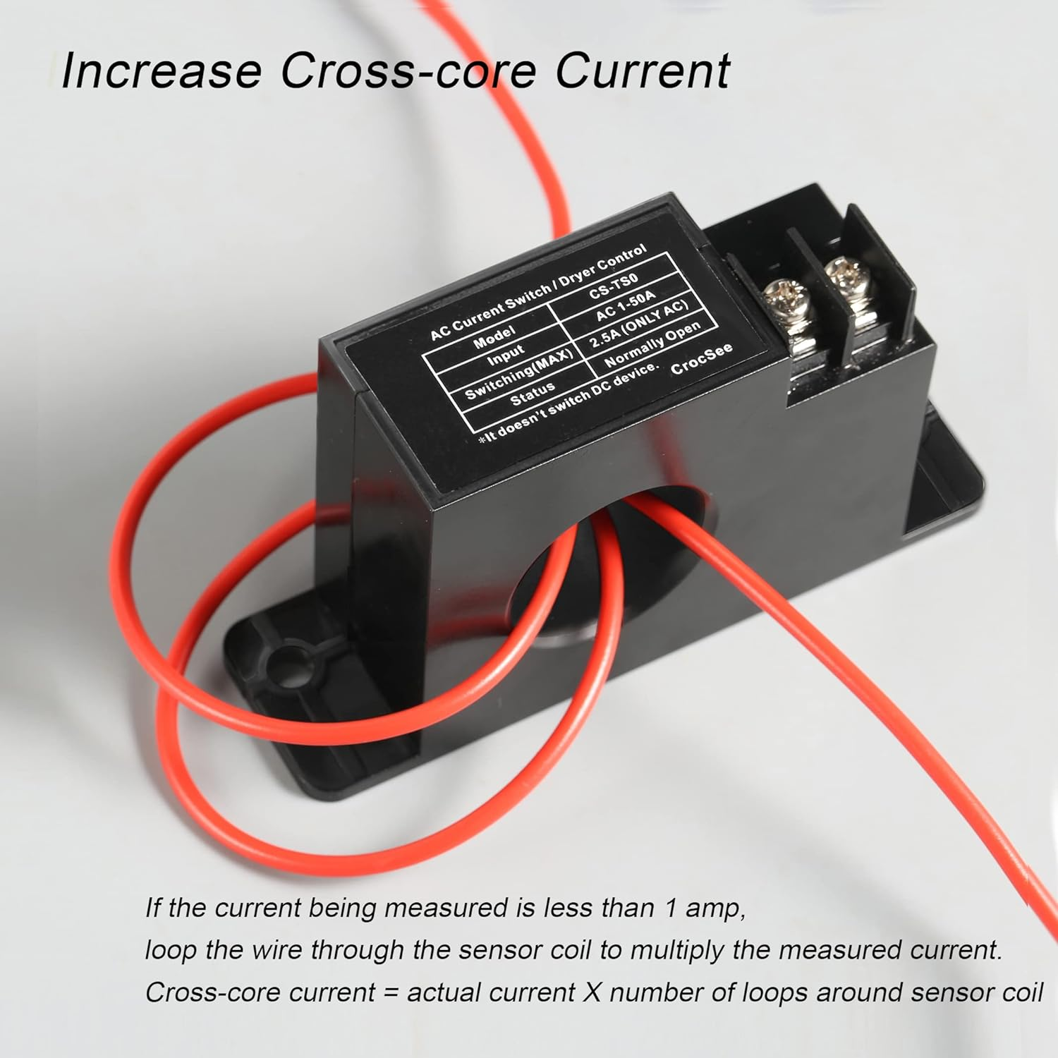

Current sensing (normal open) switch more suitable for this case, but you need found a device have enough switching capability. Pls also confirm does EMC KTN-STL3 will power on once AC input have power.
Those switch no need external power, only need main wire pass-through it.
!! Below are example only !!.
https://a.co/d/8eiFl3s
Edited by Vr2Io
These great, I think 1s delay on not a problem.
