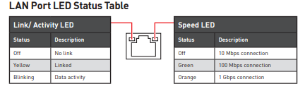

When machine in sleep ( S3 S4 S5 ) does ethernet still link up ? If not, WOL won't work, no matter what you do.
Edited by Vr2Io
I did confirm that the ethernet port had a yellow light once it was "sleeping".
I also confirmed with ethtool the correct state before after initiating sleep.
all made no difference ...which is why i went with the "any key" solution
thanks for the info @Vr2Io
