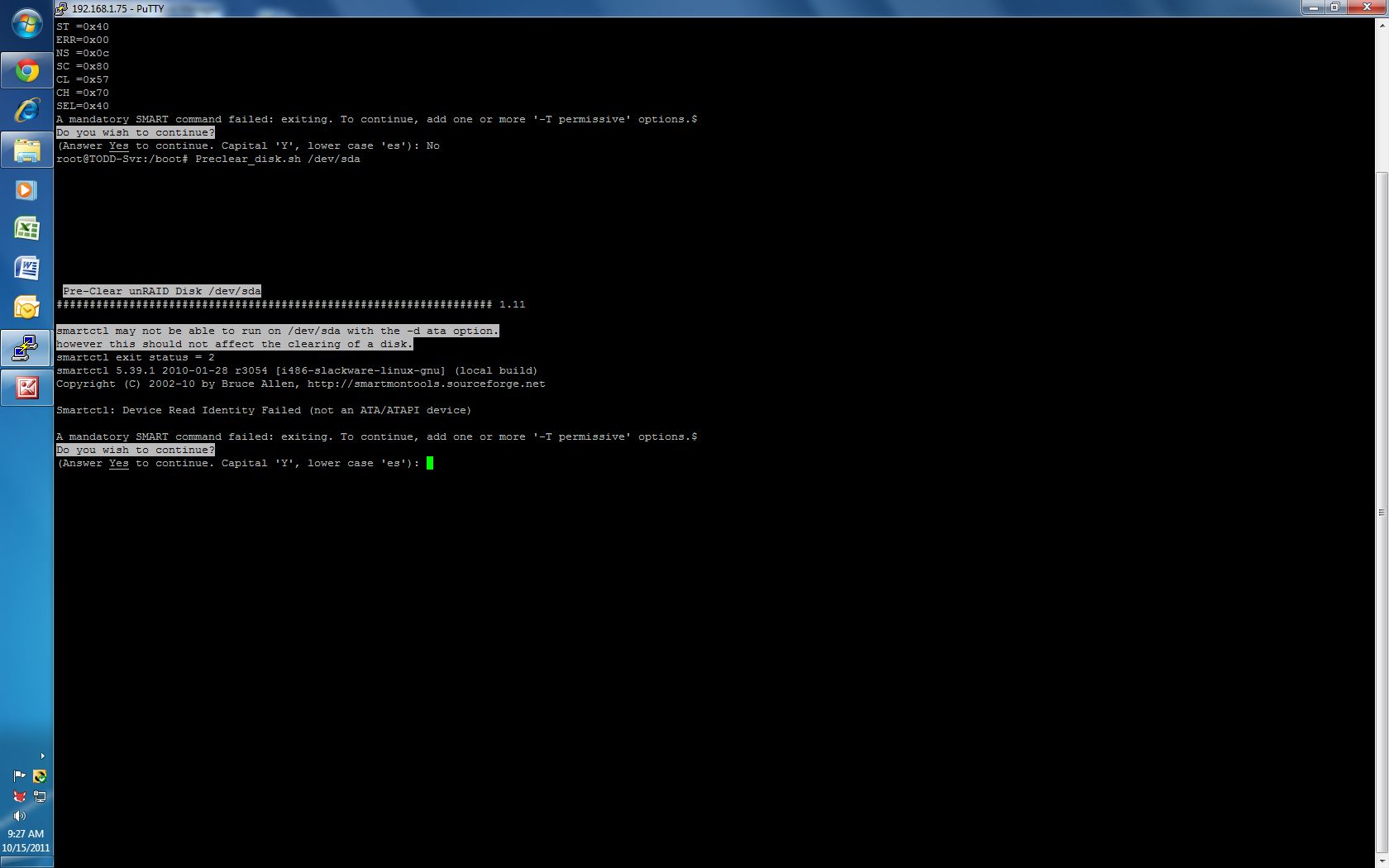

I'm at the final stage, and preclearing two drives.  One is a year or two old NTFS formatted drive I am preclearing to add to the array, and one is a USB external drive I will not have in the array.  Just using preclear to test it before formatting it NTFS on a Win 7 computer.
The USB drive is showing up as dev sda and the other drive is dev sdd.  I have attached screenshots of the error I get in preclear.  It says I can continue, but I want to know what the issue is before I do as I've never got this on a preclear before.

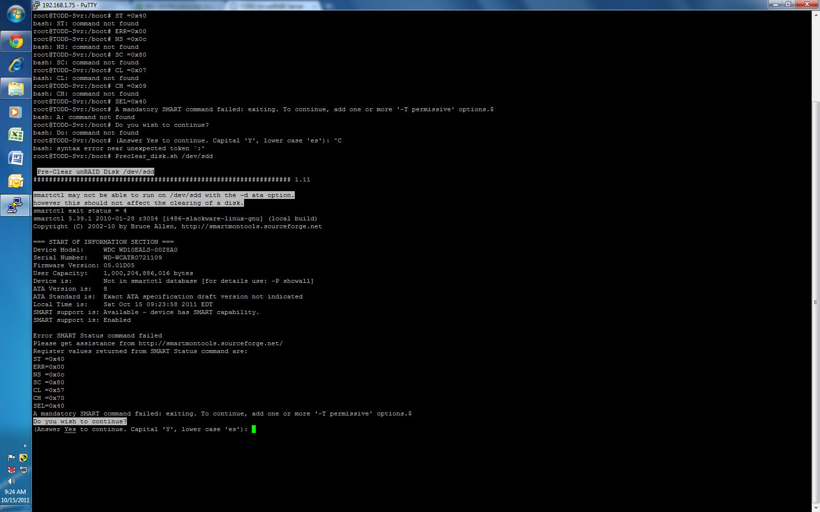

Here is the other drive, sdd
Ignore all the stuff above the start of preclear.  I tried to highlight and right click on the text to do a copy paste in a telnet session.  I didnt expect it to work, but tried and that's where all those lines came from.

Oct 15 09:19:50 TODD-Svr kernel: sd 0:0:0:0: [sda] Assuming drive cache: write through (Drive related)

Oct 15 09:22:08 TODD-Svr ata_id[4407]: HDIO_GET_IDENTITY failed for '/dev/block/8:48'  (Minor Issues)
Oct 15 09:22:08 TODD-Svr kernel:  sdd: sdd1 sdd2 (Drive related)
Oct 15 09:23:58 TODD-Svr ata_id[4856]: HDIO_GET_IDENTITY failed for '/dev/block/8:48'  (Minor Issues)
Oct 15 09:23:58 TODD-Svr kernel:  sdd: sdd1 sdd2 (Drive related)
try using the most current version of the preclear script.  Yours is 3 version old.
If updating the preclear script doesn't work, try a different port in your system...like a motherboard port.  Although I haven't hit it personally, I've read a few reports on the forums where some controllers don't play as well with smartctl as others.  If it were me, my goal would be to get a nice, clean report...and even though this error might not affect the preclear, for my comfort...I'd want it to run optimally unless there were no other options.

I can try a different port but here is the puzzling part.
1. I just precleared two brand new 500 GB Hitachi drives without error.  One of them was connected to this port / cable.
2. I have already precleared an identical drive to the one connected to this port months ago.  It was bought at the same time and is currently plugged into a different cable on the same SAS port for this card.
3. I am getting a similar smart error trying to preclear a usb connected drive.  (see above).  this is a totally different interface.
Because of thsoe reasons, i'm leaning away from it being a port issue, but will try anything to rule it out completely.
The new preclear script appears to have resolve this issue.
Thanks.
