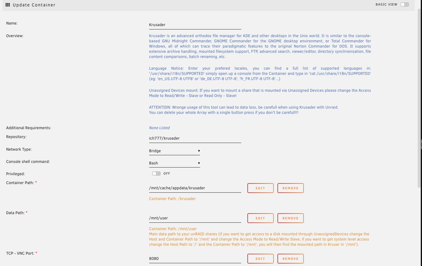

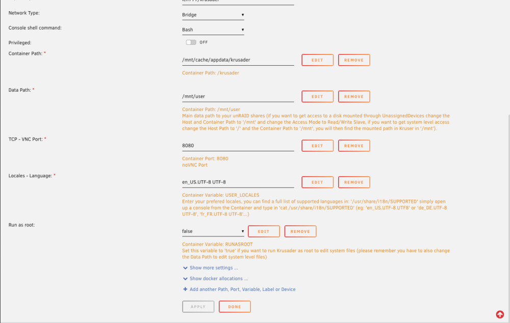

Is this what you mean by settings?
1903351954_ScreenShot2024-01-22at2_10_02PM.thumb.png.4c76d5a34fc1839064089758815fabac.png1221695055_ScreenShot2024-01-22at2_10_14PM.thumb.png.7de6255e36ec9e58a5c7c8b3025816ea.png
The only mapping you have is to /mnt/user which is where User Shares are mounted.   Local drives mounted by UD appear under  /mnt/disks and remote shares under /mnt/remote.   If you want Krusader to be able to access either of these then you need to add volume mappings to support this.

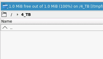

I must still have something not quite right, I can get to the drive but it won't show me the contents.
I have connected it to my other server without issue, but the USB shows none of the contents.
Edited by ProblemWithField
doh, sorry I got it, I had it under remote rather than disk.  Thanks!
