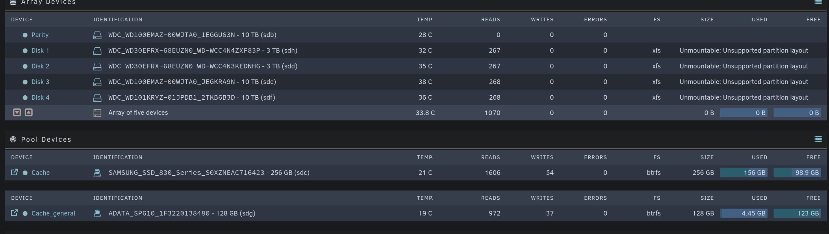

Following the guide here I've attempted an XFS repair on one of my drives. This looks to complete successfully but when stopping the array and restarting it to get out of maintenance mode it still shows unmountable
Basically I'm doing the following:
1. Start array in maintenance mode
2. Run xfs repair on drive
3. Stop array
4. Start array - see drive is still unmountable
5. Repeat

Unsupported partition layout is not a filesystem issue, and the fdisk output shows that there's no partition, if parity is valid, simplest way to fix this is to unassign one of the disks, start the array, Unraid will recreate the partition, if the emulated disk mounts and contents look correct you can rebuild on top, then repeat for the remaining disks one at a time.
Another option would be to recreate the partitions, but since Unraid can use two different layouts it may be trial and error.
Unmounting a disk shows the emulated drive and contents look ok. Where do I find the option to rebuild?
EDIT: Think I got it. Stopped the array again, added the disk back, and starting the array again triggered a rebuild. Going to take a touch over 5 hours for my 3TB drive. From there I just need to do this again with each drive? Is there a way once I know the partition format to create that on the other drives without a full rebuild?
