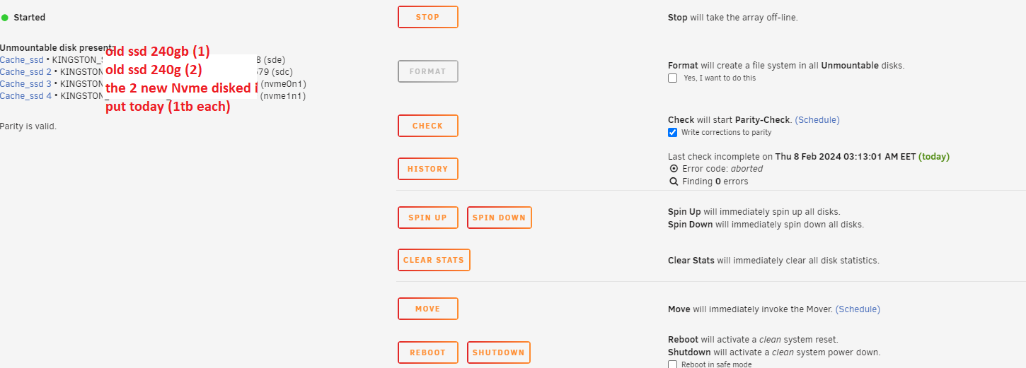

Hello Unraid Community,
I'm encountering an issue and could really use some help. Here's the situation:
I have a pool consisting of 2 SSDs, each 240GB, set up in encrypted btrfs mode for redundancy. Today, I added 2 NVMe drives to this pool, bringing the total to 4 drives.
After starting the array, the new drives were all built, and I was able to use the pool as before.
However, when I attempted to remove one disk, I couldn't start the array because too many drives were missing (despite having the box checked next to the start button).
After trying to troubleshoot with the Unassigned Devices plugin, following a forum post, I ended up breaking the pool. Now, all 4 drives need to be formatted. This is problematic because all my Docker files are stored in this pool.
I'm at a loss for what to do next. Any advice from my fellow Unraiders would be greatly appreciated.

Problem is still here, Unmountable disk present: in all 4 drives.
New Diagnostics:
2hermes-diagnostics-20240208-1629.zip

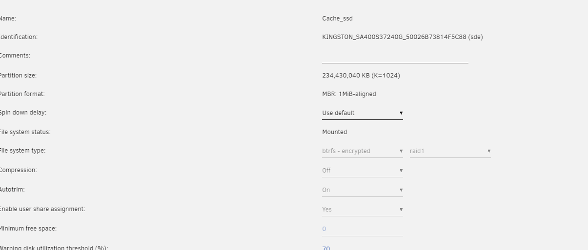

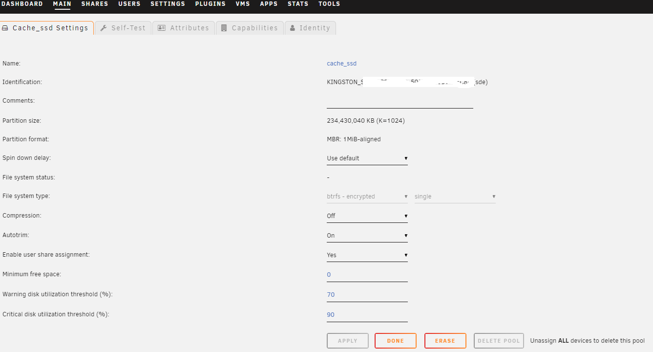

Btw I just saw that the File System is set to auto. i didn't change that. its was btrfs encrypted if i remember correctly. shall I do something?

Just to clarify again, Return you mean the button Enter in keyboard OR shift+Enter ??
done it with shift+ enter hope its good.
3hermes-diagnostics-20240209-1930.zip

Output above looks good, according to diags the 4 pools devices are assigned correctly, the pool is still unmountable of course, so just stop the array, start the array again, post new diags.

I Follow your steps but i Can't remove the ssd..... also look in forums but maybe i am bigger noob than i thought.
Steps:
1)I start Array
2) i Click Cache_SSD in main tab, i go to Settings tab
3) In balance dropdown Menu i select Conver to raid1  and i Hit Balance now button
4) I wait balance to stop and i stop array
5)i go to Pool, remove the last SSD (nvme of 1tb) and I try to start array with the "remove this device from pool" ticked  (but not the Maintance mode)
6) I Get Error...... (Wrong Pool State...)
BTW while the array is running, It tells me Its raid1 , When i stop array its says in BTRFs Single mode......
5hermes-diagnostics-20240211-1237.zip
Edited by Hermis
Possibly the profile is not being correctly updated after the conversion, edit /boot/config/pools/cache_ssd.cfg and change diskFsProfile="single" to diskFsProfile="raid1", then try again, a reboot before may be needed.
