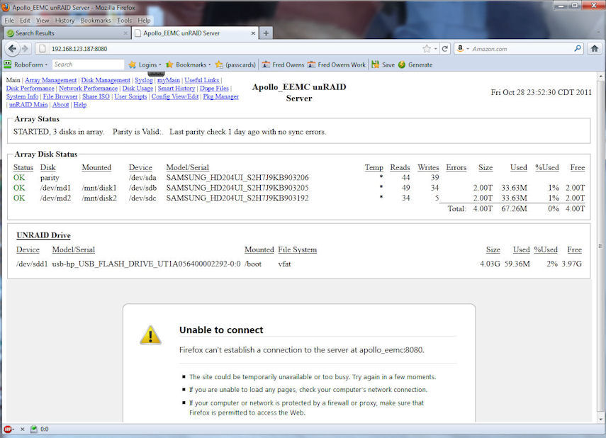

I turned off my internet security suite completely but it made no difference. If I simply enter the Ip.add.ress the page still loaded blank. I remembered that someone said by adding :8080 I might be able to see the server and I can - screen shot attached - but none of the links work because I cannot get it to ask me to login. This is if I simply enter the Ip.add.ress then :8080 If I open Internet Explorer and enter the Ip.add.ress or the servername I get windows file explorer open to the shares with no password protection and no login required. I can add or delete files at will  Nothing I do in Internet explorer allows me to see the web gui. That's my Windows 7 X64 Home PC - my Win 7 X64 laptop behaves the same way. BitDefender Internet Suite 2012

I can get the screen shown inthe attached capture up by using the :8080 but it's just a picture, nothing works.

I found out by going through the old "turn everything off and if it works turn stuff on one at a time" routine, that apparently even when Bit Defender is turned off it isn't. In safe mode I can connect. I turn off Spybot's Tea Time and Bit Defender - all items related to it about 4 I think. I can turn Spybot on and it still connects but when I turn on BD it won't.
I chatted on-line their tech support this afternoon for a couple of hours and they were stumped as well but level 2 said BD was partially on even when it was off. I guess that's good protection but annoying in this case. I had whitelisted the server before and turned off HTTP scanning as others had trouble there but it made no difference. So I zipped up their logs and sent it to their upper level support to figure out.
