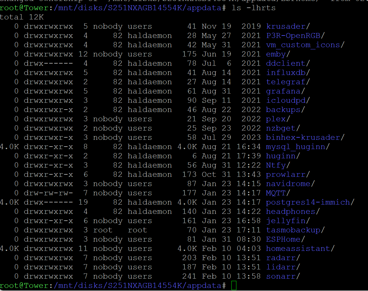

At some point I noticed that plex, jellyfin, and some other docker apps weren't working properly.  I went through my troubleshooting routine and noticed that somehow all the folders in appdata had the owner changed to  haldaemon for some reason. I was able to fix the issue by changing the owner and permissions back to nobody users, but was wondering if anyone has had this happen to them before or if anyone knew why this would happen?

It is not the   owner     that is being changed to      haldaemon    from    users     , it is the    group     .    The    owner     is being changed to     82    from     nobody   .
The thing that I noticed is that the    appdata      directory in not in    /mnt/user    which is where I would expect it to be.  Whether that is a problem, I am not sure.   Perhaps, you have an explanation as to its present location.
