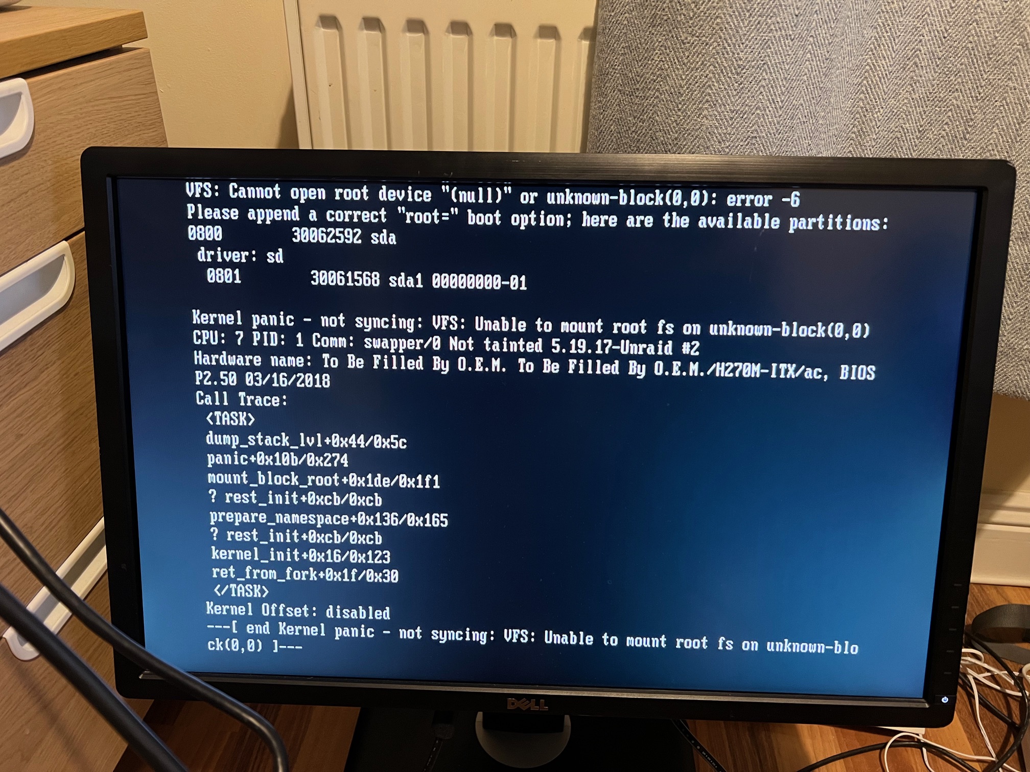

Managed to at least get a monitor attached to it, and booted with a head attached. Kernel Panic!
So seems the way forward is to download the same version I currently have (eek) and just overwrite the bz. files with the new ones?
You should probably fix the corruption. Or just copy what you can of config, reformat, reinstall, copy config back.
