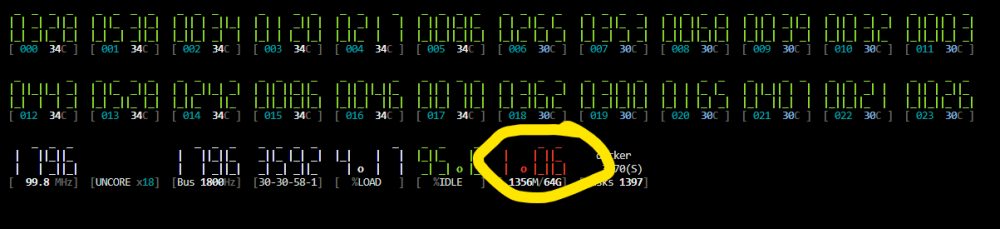

I installed CoreFreq because I'm see erratic swings in my CPU temps. I have a Vetroo V240 water cooling system which seems to be doing it's job, but I had my tower in a corner under a coffee table and when putting somewhat of a load on the CPU my server would crash. I rarely push my CPU past 50% with gaming and decoding video (H265 conversion). Do I have a shitty watercooling system for the X3D CPU or is there fan control settings in Unraid I'm unaware of?
Also what does the red number circled in yellow represent?
Solved by BigDaddyDingDong
That red number is the percent of available memory.
It is based on "Free RAM" and "Total RAM" values displayed in the "Kernel" window
percent = (100. * freeram) / totalram
Red Threshold is about 15% left

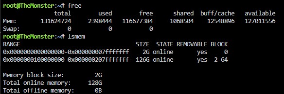

Total RAM is sourced from Kernel. What does memory command gives you ?
free -m

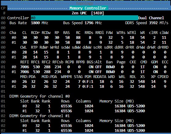

Is this what you were wanting?
The other menu called Memory Controller.
We should see timings and geometry, including size of DRAM
Edited by CyrIng
Sorry, thought that was it but I was mistaken. here it is. Once I get a chance to shut down the server I'm going to enable AMD Expo mode as well.
Thanks,
To what I can see, the total is 64GB
* Has CoreFreq only found one controller with 4 DIMMs 16GB each ? If you scroll, don't see you other controllers ?
* Can you open a terminal and read the RAM size. You can use command `free` or `lsmem`

I ran both commands and this is what I got.
I ran a memtest and disabled CPU C-State and now everything is where it should be... 🤦‍♂️

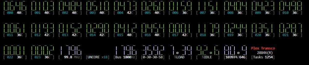

After running for a few hours the ram slowly filled up again. I did some research and this is a normal feature for Linux to use up all your RAM as "Dirty Cache".
I'm searching for your DIMM and finding FLBD564G5200HC40CDC01
I think that if the CoreFreq computed DIMM geometry is wrong, it's because I'm facing some Register bits I have not encountered so far.
My assumption is that DIMM ranks should have felt to a value of two
Fyi, if you compute the product as below, you will get the DIMM size
Bank x Rank x Rows x Columns
(32 x 2 x 65536 x 1024) x 8 Bytes
So I need to debug Registers to guess the missing bits.
Edited by CyrIng

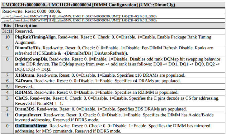

I see the issue.
I have based the Rank number on OnDimmMirror
But this field only applies to DDR4
Edit: because processor is 7900X3D, maybe Dram3DS is a discriminant to guess Rank
Edited by CyrIng
