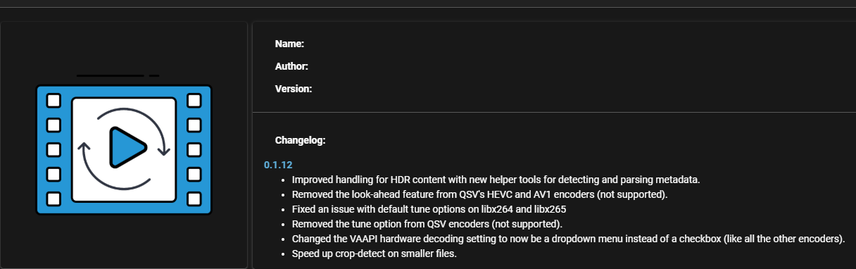

  3. Found that I can change it to nvenc in the settings of the plug-in and decide whether it is H264, H265, or AVi in those settings as well.
  4. Been using Unmanic for a while, now all of a sudden it took a crap on me and started having issues. I'm using an Nvidia GPU to transcode and when re-installing the docker I noticed a lot of the video conversion plugins are missing. All I have now is this plugin for videos from the JOSH.5 Repo. Is this now just a 1 size fits all transcoding plugin? No options for H.264, H.265, AV1 or if it supports Nvidia, AMD, or Intel.

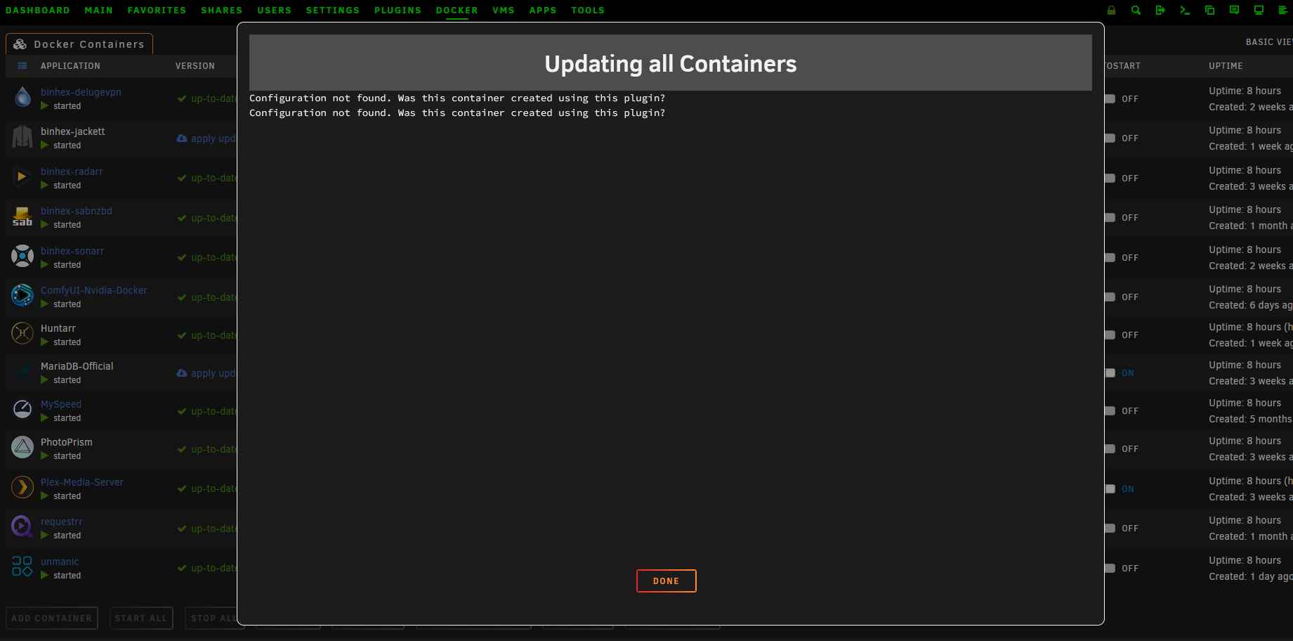

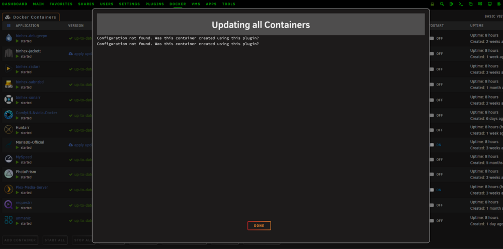

  6. I've read other posts about users just deleting their dockers and reinstalling them when this error occurs. I'd rather not have to go through and set up all my Docker containers all over again. I had to restore my USB drive after some issues I had with the latest Unraid update, and after firing up everything, I noticed I got this error whenever I try to update containers.

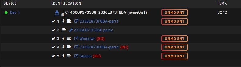

  14. @BKG@BKG can you go to the "main" tab and then click on "cache" under "pool devices" and take a screenshot of your cache setup and post it? Something may have changed during the 7.0.0 update in your cache settings causing you to have problems. I'm assuming you also have the unassigned devices plugin as well?
