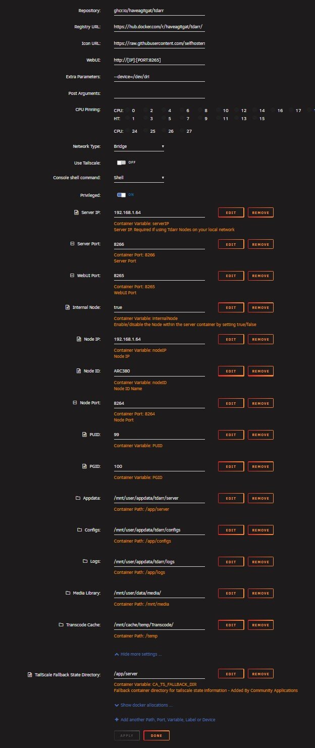

@Dustin Turner Hey, I just got my ARC A380 and went from a Quadro P2000 with the intent of switching from hvec to av1. I followed the same guide you did and noticed there was some errors with the flow. Here's the adjusted flow in the txt file and a shot of my TDarr Docker settings. Sorry no one got back to you. Unraid community isn't the most responsive for being as popular as it is.
