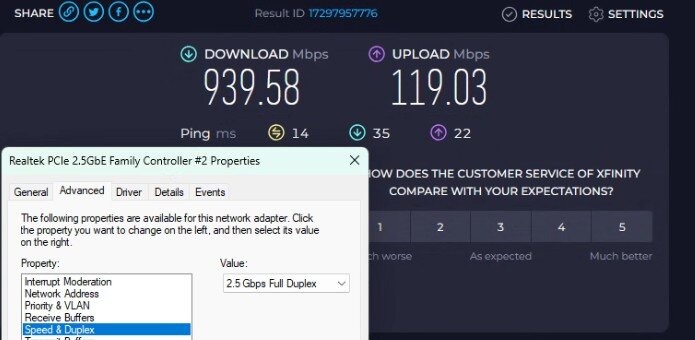

  18. @JorgeB I got it figured out. My NIC was set at 100mb/s in the properties. I have no idea why Windows would pre-set it like that. All good now though.

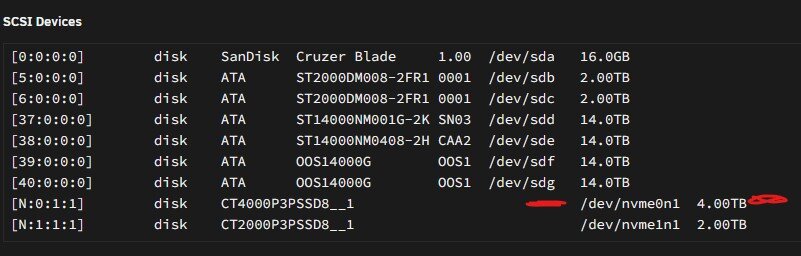

  19. I passed through my SSD a different than most suggest. I followed SpaceInvader Guide but I had to use the midnight command to find the actual location and name of my drive. 1. open up terminal of the top right hand side of the Unraid GUI. 2. type MC Once you're in midnight command locate your NVME drive by going to /dev/disk/by-id/ 3. take that disk id and plug it into the primary vDisk location as I've attached in my photo.

  23. I figured it out. I left it unassigned and installed the vdisk.img on my cache drive then converted the vdisk to a physical disk onto my unassigned NVME. From then I was able to partition the drive from within the VM. I left the vdisk @ 64 GB so it wouldn't take much time to convert to a physical disk. An issue I had was mounting the unassigned NVME to my VM when editing XML. I couldn't use (dev/disk/by-id/ata-CT4000P3PSSD8_2336E873F8BA). This kept giving me an error. Instead, I had to mount using (dev/nvme0n1). The bad part is that when I reboot Unraid it changes with nvme1n1. Every reboot they trade 👎. My VM is running faster than it's ever run. Running on a passthrough NIC and raw nvme! life is good!!! I had to be sure I reset my Unraid USB as the only bootable disc or my server would boot up into the physical Windows disk I created in nvme0n1. Amazing SpaceInvader video Ok, quick update! I found out how to locate the name of my nvme. It is "nvme-" not "ata-" /dev/disk/by-id/nvme-CT4000P3PSSD8_2336E873F8BA I went into the terminal and went into midnight command mc Went into the location "dev/disk/by-id/" and found my disk.

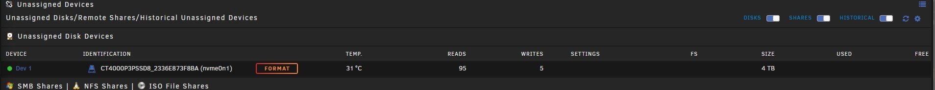

  24. I have been looking up guides and came across this one created by @N3z a few years ago I guess (Creating a Windows 11 Gaming VM) and I saw a video that SpaceInvader made regarding his VM where he passed through his SSD. I cannot get my unassigned SSD available to passthrough in the Tools/System Devices section. I can passthrough my GPU & GPU audio and my added NIC. But I can't get this damn SSD. Secondly, I saw a video where SpaceInvader had his SSD partitioned so he wouldn't lose all his games and whatnot if he ever had to reinstall his VM. Smart idea but he never shows you how to partition a drive in Unraid as he had it. Spaceinvader One Video Please help passthrough my SSD and partition my SSD 🙏
