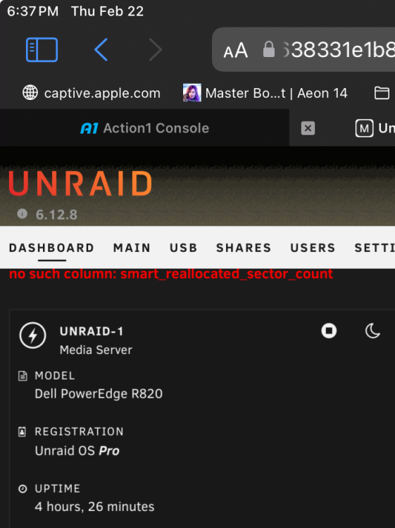

no such column: smart_reallocated_sector_count
I just started seeing the error “no such column: smart_reallocated_sector_count”. It is in red text just below the top menu bar.
Solved by Haroeris
Hey, if you have not worked it out already, I figured I would just say I encountered this and in my case at least it looks to be caused by the Disk Location plugin. Unfortunately I was unable to find a fix so had to remove the plugin.
I have identified that plugin as the cause of the error as well. Thanks!
This appears to be a corruption of the plugin's database. Uninstalling and reinstalling will not resolve as the database remains in it's original location. Remove or rename \\boot\flash\config\plugins\disklocation and disklocation-devel and disklocation-master if you have those folders, then reinstall plugin and reconfigure.
