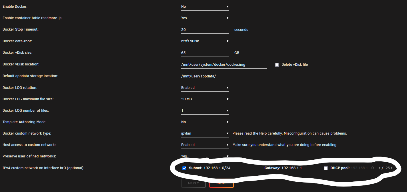

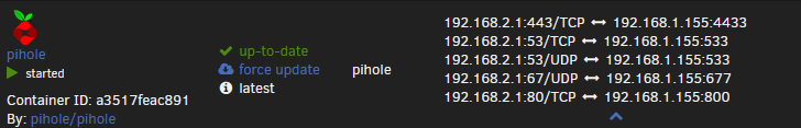

The custom IP is on the left, my unraid server IP is on the right. if I understand correctly 192.168.2.1 should be on both sides.
I cannot connect to it with any of the ip addresses/port below.
Another note is that br0 is not available as a custom network option. I turned bridging off and on, that did not bring it back, so I created a new custom network.

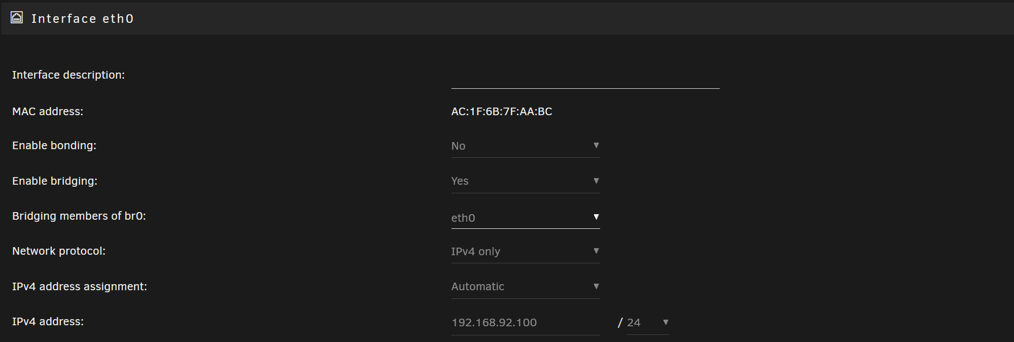

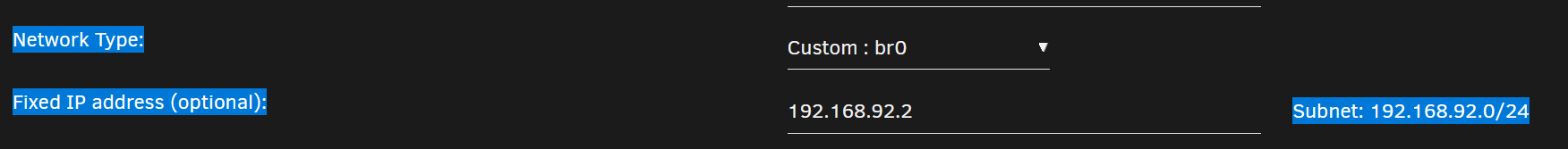

Here are my (i) pihole docker container settings; (ii) Unraid network setting; and (iii) docker settings. They work on my system.

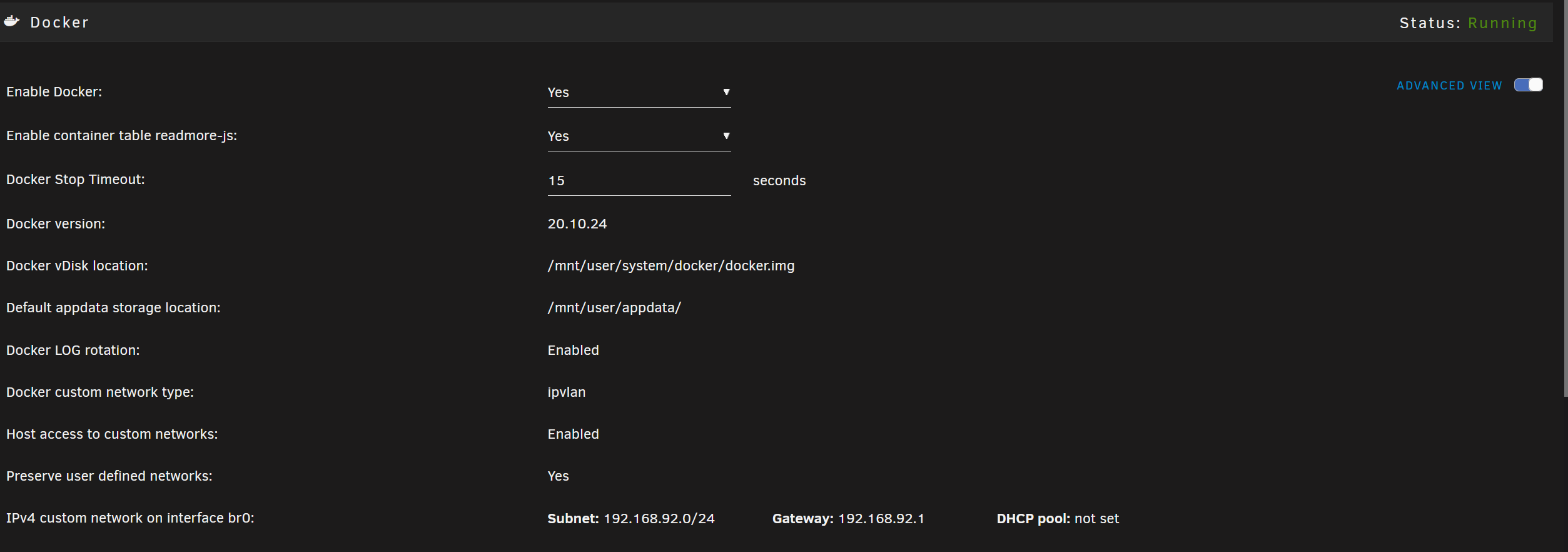

Unraid Docker Settings:
Pihole Docker settings:

Have you tried stopping the array before enabling bridging, and then starting back the array ? Also, are your other settings the same as mine ?

Can you try maybe deleting the 192.168.2.0/8 custom docker network ? This /8 CIDR seems very wrong to me on the 192.168.X.X range, as it may overlap with the 192.168.1.0/24 network.
Edited by Opawesome
I indeed see "br-fccdcfbfa4d2 UP 192.168.1.1/8" in the ifconfig file of your diagnostics, which is overlapping with your 192.168.1.0/24 LAN. That could be the issue. I would try deleting this custom docker network.

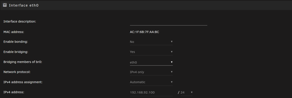

Here are the settings that worked:
