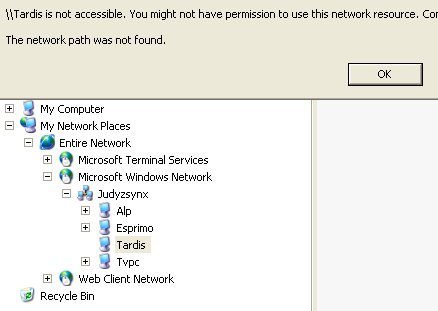

I started a 400+GB copy to it from Windows 7, and Tardis became unavailable part-way through (\\Tardis is not accessible. You might not have permission to use this network resource.)

Now, my Windows PCs can all browse to //Tardis, but none of the shares work (see attached image).
The net address is unchanged, the PCs connect through the same gigabit switch, so I think it's a share issue?

None of the shares are visible on the client machines - not even the flash or disk1/2/3 shares auto-created by unRaid.
Only the machine name (Tardis) can be seen - as in the attached...

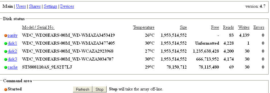

Ok - flash drive reformatted and clean installed. Have assigned drives correctly and started the array.
Disks2 and 3 are as expected, but Disk1 says unformatted (screen grab attached).
I've cancelled the parity build and not yet recreated the shares.
Have I lost the data on Disk1?
The share I was writing to when unRaid became unavailable included Disk1.
What would be the best thing to do next... ?
Thanks again!
Judy :-\
Getting a bit braver ...
followed Joe's instructions for an unformatted drive at [Topic: rebuilding USB now drives say Unformatted]
and the drive is now showing formatted - it was an MBR/file system start block mismatch - yey!
