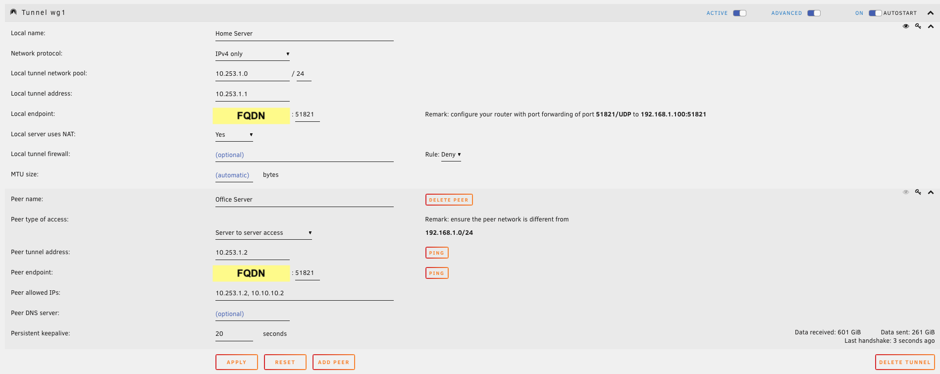

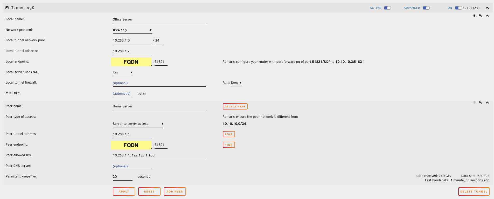

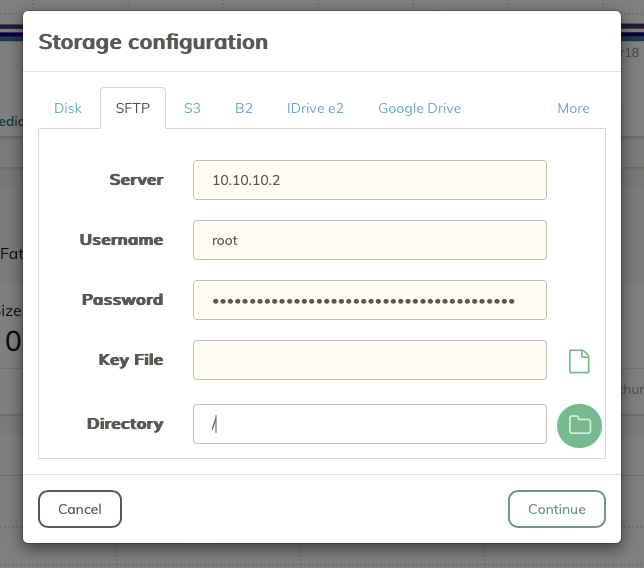

I configured a server-to-server Wireguard tunnel between the two servers so sFTP could be used without exposing each server's SSH to the internet. Once I verified (via server terminals) that ping and SSH connections were possible between servers, I knew that things were good and I configured Duplicacy for the sFTP backups. The backups have been running great.

  1. Install the DuckDNS app and set up FQDNs for access to each of your servers through the web. (used for the Wireguard endpoints)
  2. Setup Wireguard VPN tunnel between servers. (see screenshots)
  3. Forward Wireguard ports to your servers at each location.
  4. Test Wireguard tunnel is working by pinging and SSHing both directions by using each server's terminal.
  5. Install the Duplicacy app on each server.
  6. Set up Duplicacy storage locations.
    1. Enter IP address, user, password, and / in the Directory field so you can navigate from the top level.
    2. Click the Folder icon and select a folder in /mnt/user/ that you want to designate as the Storage location.
  7. Sep up Duplicacy backups and schedules.

What's the difference between all the different Wireguard configurations? (Remote access to Server, Remote access to LAN, Server to Server, etc...) It all has to do with the "Peer Allowed IPs" setting in Wireguard. For example, if ONLY each servers IPs are allowed, then you have a "Server to Server" configuration.
