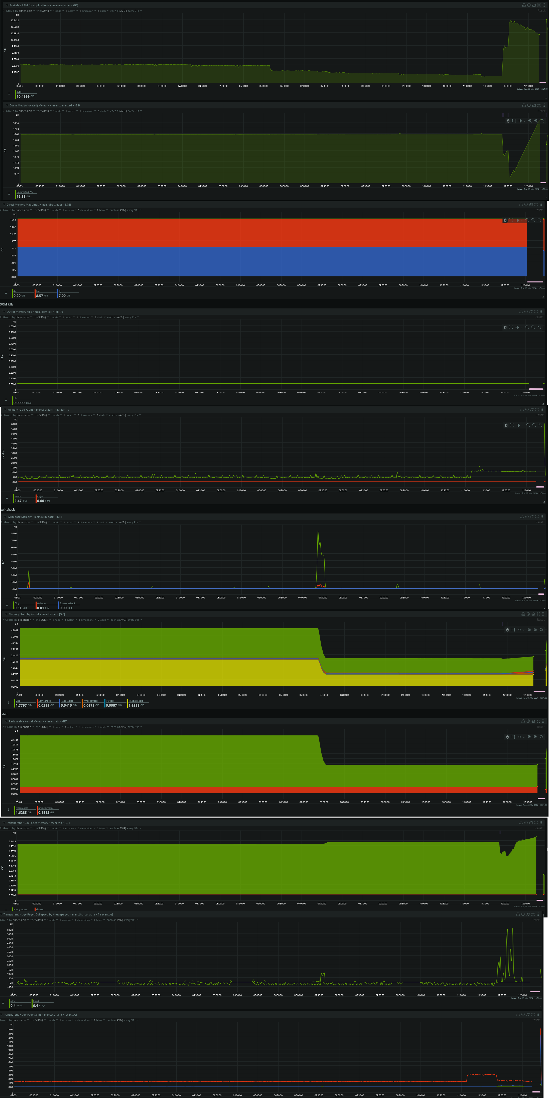

Finally, in a last ditch effort to try and get some data when this issue happens I took advantage of Docker containers that are fairly self-contained not being impacted, so I installed Netdata when I last had this issue a few days ago. This collected data even during when I was experiencing the symptoms above, I don't know if I should look for anything specific, however, some memory stats did jump out as potentially curious, most notably:
  • When I noticed the issue, around ~12pm (GMT) available RAM increased by about 1 - 1.5GB - odd but makes sense as services seemly stopped
  • Committed memory took a nose dive by about half
  • Memory page faults were increased, although I don't think that is a big issue from my limited understanding
  • Transparent Huge Pages Collapsed shot up almost 10-fold - again, not sure if that is an issue or not though
I've attached the graphs for those Netdata stats, if they help with anything, although it could just be trying to find something and focusing too much on RAM!
Many thanks in advance for anyone that made it this far 😅

I'm writing this far away from my server so it cannot hear me! I think I have gotten to the bottom of this now.
After all the above things I tried the server was up for almost 4 days before it happened again while I was using it. This time it was slightly different though:
* the unraid web ui would render the html but no styling or functionality
Everything else was the same except I was able to login via the terminal and a monitor this time. A lot of commands would return an io error. However, the syslog have me some output! Swuashfs block read errors.
Some research on this forum pointed me yo a possible dodgy flash drive, which is possible it is quite old. Plugged it into my windows PC and it did detect errors.
So I moved it over to a new flash drive and so far seems okay, been up for over a week now.
Thanks for the help and suggestions!
