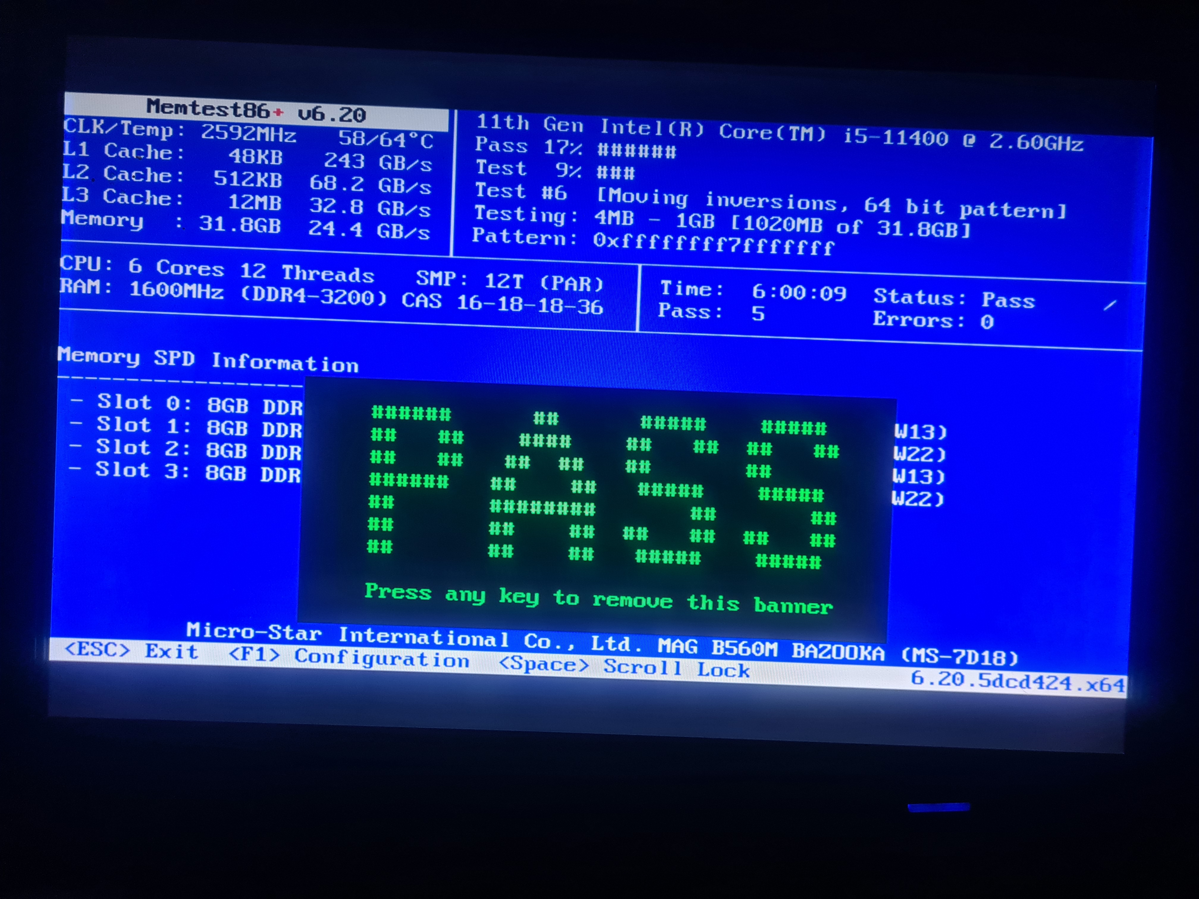

I finally got the chance to shut down my server and perform a memtest. Everything looked ok after several passes.
I then performed the scrub on the pool. (Its just the cache right?)
