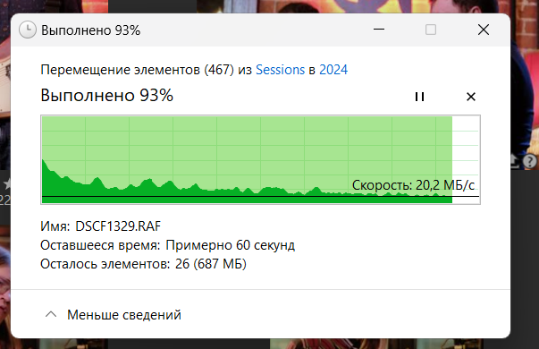

Diags and the progress copiing bar are attached. It's clearly visible speed decline during the process.

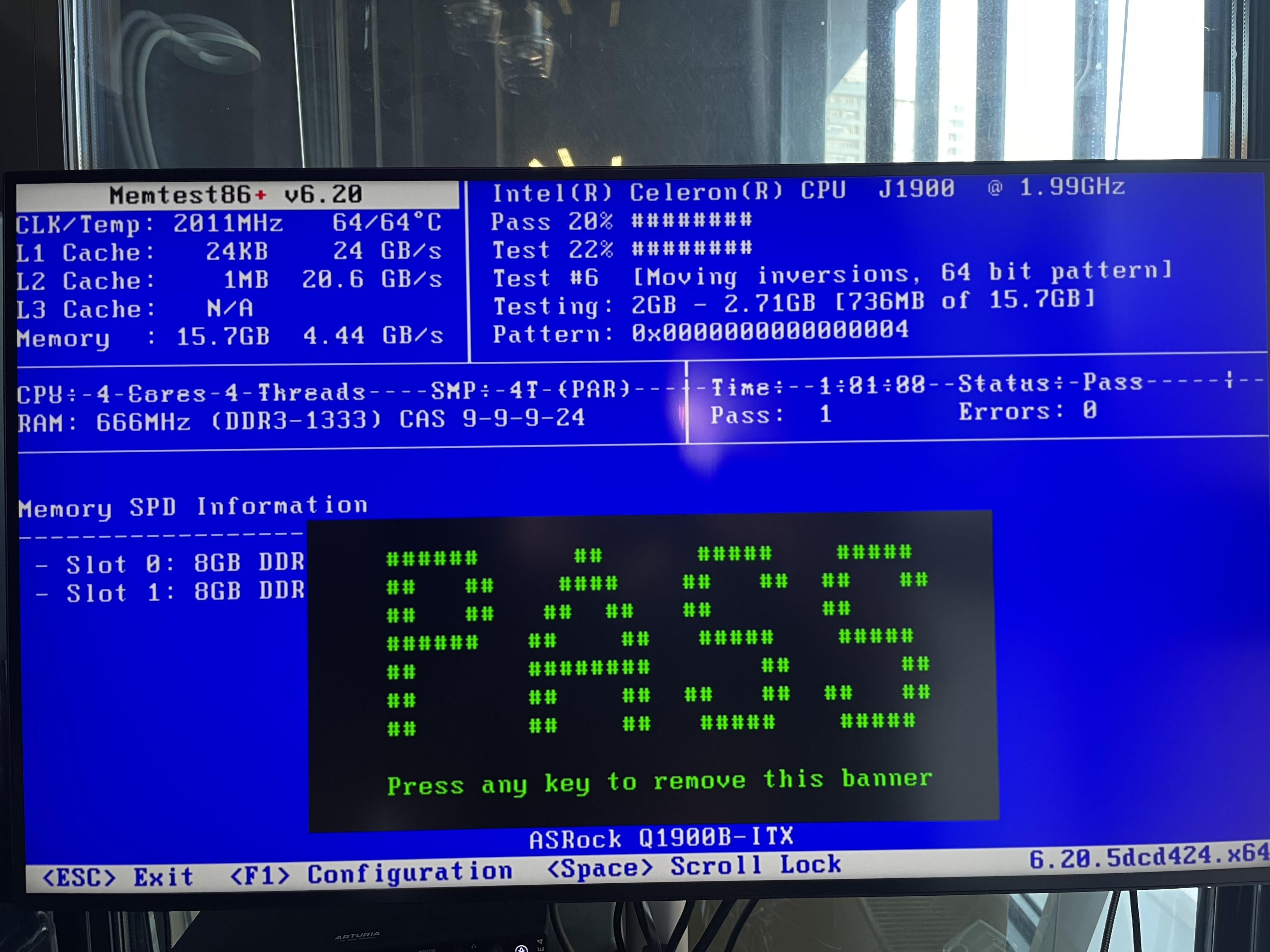

Memtest seems to be ok.
Can you please advice, what should be my next steps on both issues? (Btfrs data corruption, but I didn’t notice any data loss, and the transfer speed).

So, currently I didn't had memory issues, as per screenshot above. I've followed your link, run the command (btrfs dev stats /mnt/cache), got this:

And, again :( going back to my initial issue of the slow speed.
trying to copy to the cache from my desktop ssd - 5MB/s.
Rebooted, restarted the copy - just 7-8MB/s, not higher.

Sorry for the long silence. But here it is, the same issue.
Copying from external (main desktop, 1gbit lan, ssd nvme) to the unraid server, bu 1gbit lan, to the cache on unraid (ssd 512gb). Transfer speeds are jumping, from 30-60mbytes/ sec, sometimes dropping to below 1MB /s (see the screenshot attached). And the latest diags, taken during the copying process, is attached.
Files in copy are photos: raw, jpg files, and XMPs, a mix of everything. I guess, the main drop in speed while copying a lot of smaller XMP files, or touching (viewing) the files on the server with the other parallel process.
Should I upgrade already? ) Motherboard (+processor since it's soldered), RAM or LAN?

With smaller files the speed will be much lower, that is normal, large files appear to max out at around 65MB/s, and that is similar to the iperf tests, so also normal, you can try to retest with iperf after changing some things like NICs, cables, switch, client PC, etc, when you get the expected results with iperf, you should also get them with Unraid.
