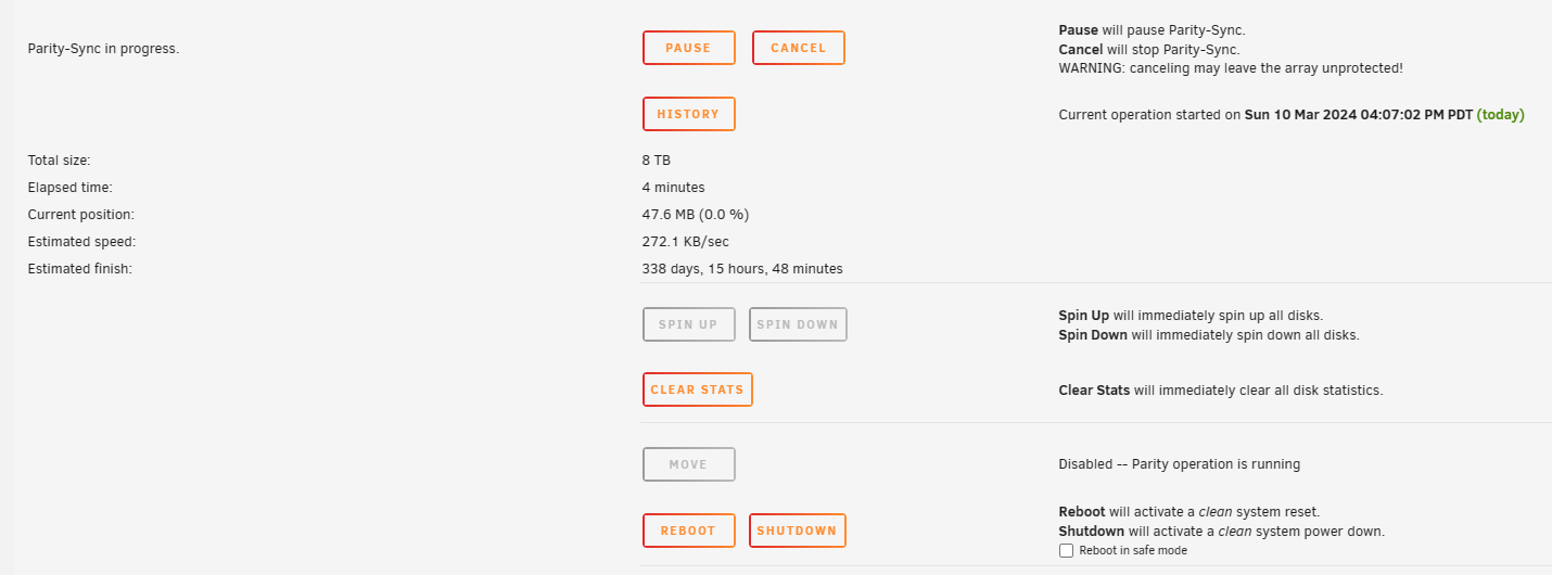

I removed proxmox from my machine, and installed unraid, as I didn't know how to do it properly, and apparently it worked well, the first “parity” synchronization was relatively quick, taking less than a day to complete, after other tests, I decided format the pendrive by backing up my key and start a kind of “clean install”. Then my problems started, the “parity” is extremely slow and I don't know what could be happening anymore.

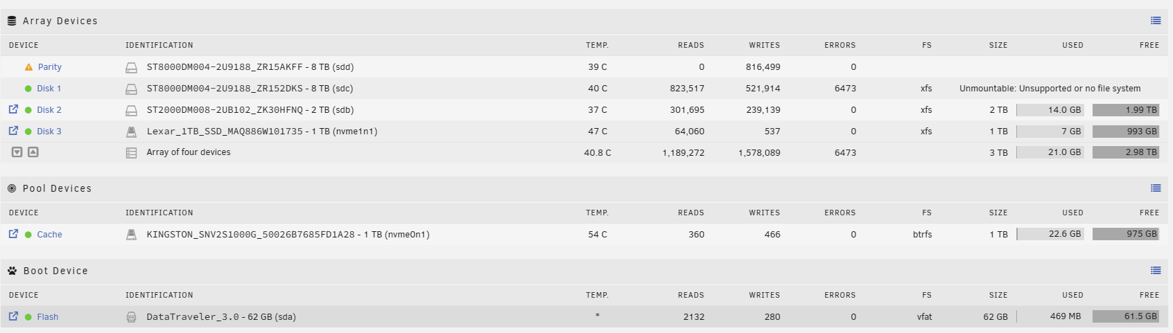

Constant ATA errors with disk1, check/replace cables and retry.

Hello my friends, how are you? I continue to face problems. I've replaced all the SATA cables, could it be the power cables? The speed remains at 245kb, and it will take about 300 days to synchronize 8TB, I honestly don't know what else it could be. I even tried to clean the disks with gparted live, but everything remains the same. I tried "new config" and nothing worked, except now it shows that one HDD is not mountable. I'm quite new to this, I don't know how to proceed anymore, I'm going to attach a new diagnostic, I hope you can help me. Thank you.

I'd like to share my experience so far. I don't know if I mentioned this, but I didn't have anything saved on Unraid; I was just testing. So, I removed the HDDs, took them to Windows, and used Disk Partition Assistant. I deleted all the partitions on the disks, created new ones, formatted them, and removed the disks. When they were put back into my server, they started to perform at a relatively satisfactory speed, given that I was previously at a very low speed. At this moment, it's at 190mb.
After more testing at this low speed and before finishing the "parity," I rebooted, and again the speeds became low, but a bit above what it was the first time (1mb).

Still issues with disk1, did you replace both cables? You can also swap with another disk.
