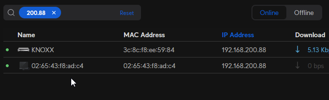

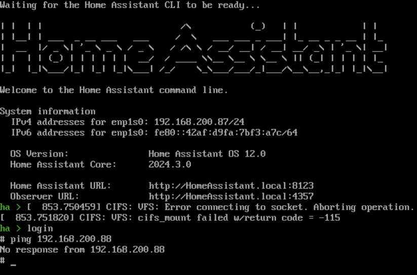

March 11, 20242 yr I had the issue of duplicate IP's on my network and happened across another post that seemed to sort things out. But it introduced a new issue that I haven't been able to figure out. I figured out my error after re-reading the post @murkus wrote. I had the custom network for the eth0 still enabled in the docker config. That solved the duplicate IP, different MAC issue! BUT! I seem to have now run into another problem. HAOS VM is using the vhost0 network and it is accessible on the network. But there was an error in HAOS about a failed mounted network storage volume that is located on the host system. [853.7504591] CIFS: VFS: Error connecting to socket. Aborting operation. [853.7518201] CIFS: VFS: cifs mount failed w/return code = -115 After pulling my hair out I determined that while everyone on the network can access the HAOS website, and HAOS can ping and mount shares on other systems, HAOS can't ping or mount anything on the host system and the host system can't ping the VM. HOST (UnRaid): 192.168.200.88 HAOS VM: 192.168.200.87 Can't ping VM from HOST root@KNOXX:~# ping 192.168.200.87 PING 192.168.200.87 (192.168.200.87) 56(84) bytes of data. From 192.168.200.88 icmp_seq=1 Destination Host Unreachable From 192.168.200.88 icmp_seq=2 Destination Host Unreachable From 192.168.200.88 icmp_seq=3 Destination Host Unreachable From 192.168.200.88 icmp_seq=4 Destination Host Unreachable From 192.168.200.88 icmp_seq=5 Destination Host Unreachable From 192.168.200.88 icmp_seq=6 Destination Host Unreachable From 192.168.200.88 icmp_seq=7 Destination Host Unreachable ^C --- 192.168.200.87 ping statistics --- 8 packets transmitted, 0 received, +7 errors, 100% packet loss, time 7195ms pipe 4 root@KNOXX:~# Can't ping HOST from VM Host UnRaid routing table root@KNOXX:~# ip route default via 192.168.200.1 dev eth0 metric 1 default via 192.168.202.1 dev eth0.2 metric 2 172.17.0.0/16 dev docker0 proto kernel scope link src 172.17.0.1 linkdown 192.168.122.0/24 dev virbr0 proto kernel scope link src 192.168.122.1 linkdown 192.168.200.0/24 dev eth0 proto kernel scope link src 192.168.200.88 metric 1 192.168.200.0/24 dev br1 proto kernel scope link src 192.168.200.253 metric 1 linkdown 192.168.202.0/24 dev vhost0.2 proto kernel scope link src 192.168.202.2 192.168.202.0/24 dev eth0.2 proto kernel scope link src 192.168.202.2 metric 1 root@KNOXX:~# HAOS VM routing table # ip route default via 192.168.200.1 dev enp1s0 proto static metric 100 172.30.32.O/23 dev hassio proto kernel scope link src 172.30.32.1 172.30.232.0/23 dev docker0 proto kernel scope link src 172.30.232.1 192.168.2OO.0/24 dev enp1s0 proto kernel scope link src 192.168.2OO.87 metric 100 Any thoughts??

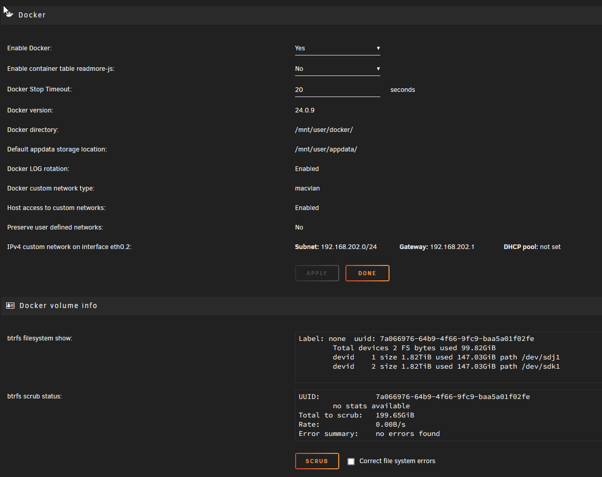

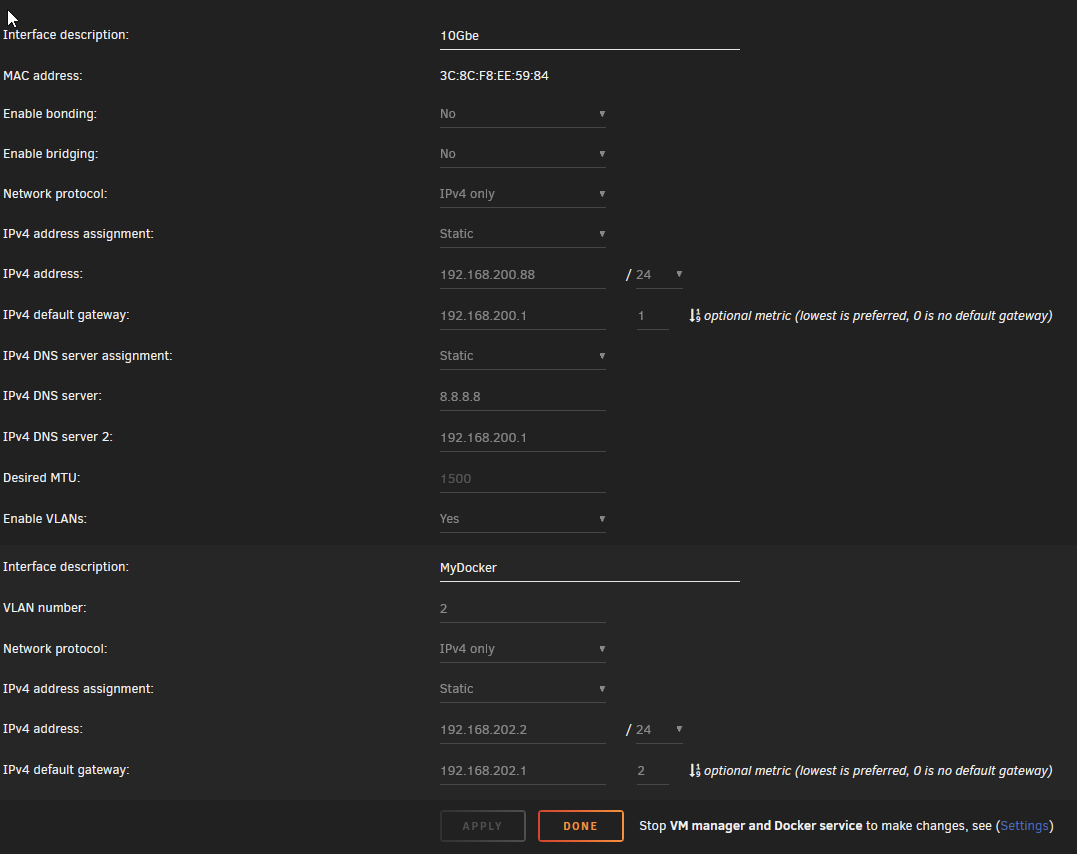

March 14, 20242 yr Author BUMP This has to be an issue with UR as I can map SMB drives in HAOS on other systems on the network. It's just connecting to the host IP address or hostname that does not work. Also, the duplicate HOST IP is on the network again with a different MAC. I suspect that this is the main culprit. I believe the HAOS VM, because it goes through the MACVTAP, it believes that eth0.2 'IS' the system I am trying to connect to. Since there are no shares there (it's a bridge after all) it fails. I've cleaned up a bunch of things that were not being used, mainly extra NICs that were in the system that I chose not to use. There is only one physical NIC in the system now and it has no bridging or bonding set. I do have a VLAN configured on it and that is being used for most of my Docker containers. Docker config Now from what I gather, because I have a VLAN set, the system is creating a VHOST for it, eth0.2 as well as etho. It is the MAC for eth0.2 that is causing the duplicated HOST IP on the network root@KNOXX:~# ip addr 1: lo: <LOOPBACK,UP,LOWER_UP> mtu 65536 qdisc noqueue state UNKNOWN group default qlen 1000 link/loopback 00:00:00:00:00:00 brd 00:00:00:00:00:00 inet 127.0.0.1/8 scope host lo valid_lft forever preferred_lft forever inet6 ::1/128 scope host valid_lft forever preferred_lft forever 2: tunl0@NONE: <NOARP> mtu 1480 qdisc noop state DOWN group default qlen 1000 link/ipip 0.0.0.0 brd 0.0.0.0 4: eth0: <BROADCAST,MULTICAST,UP,LOWER_UP> mtu 1500 qdisc mq state UP group default qlen 1000 link/ether 3c:8c:f8:ee:59:84 brd ff:ff:ff:ff:ff:ff inet 192.168.200.88/24 metric 1 scope global eth0 valid_lft forever preferred_lft forever 5: eth0.2@eth0: <BROADCAST,MULTICAST,UP,LOWER_UP> mtu 1500 qdisc noqueue state UP group default qlen 1000 link/ether 3c:8c:f8:ee:59:84 brd ff:ff:ff:ff:ff:ff inet 192.168.202.2/24 metric 1 scope global eth0.2 valid_lft forever preferred_lft forever 6: vhost0@eth0: <BROADCAST,MULTICAST,UP,LOWER_UP> mtu 1500 qdisc fq state UP group default qlen 500 link/ether 02:65:43:f8:ad:c4 brd ff:ff:ff:ff:ff:ff 7: [email protected]: <BROADCAST,MULTICAST,UP,LOWER_UP> mtu 1500 qdisc fq state UP group default qlen 500 link/ether 02:65:43:f8:ad:c4 brd ff:ff:ff:ff:ff:ff inet 192.168.202.2/24 scope global vhost0.2 valid_lft forever preferred_lft forever 8: docker0: <NO-CARRIER,BROADCAST,MULTICAST,UP> mtu 1500 qdisc noqueue state DOWN group default link/ether 02:42:b4:d2:d6:aa brd ff:ff:ff:ff:ff:ff inet 172.17.0.1/16 brd 172.17.255.255 scope global docker0 valid_lft forever preferred_lft forever 10: virbr0: <NO-CARRIER,BROADCAST,MULTICAST,UP> mtu 1500 qdisc noqueue state DOWN group default qlen 1000 link/ether 52:54:00:ca:33:2d brd ff:ff:ff:ff:ff:ff inet 192.168.122.1/24 brd 192.168.122.255 scope global virbr0 valid_lft forever preferred_lft forever 11: macvtap0@eth0: <BROADCAST,MULTICAST,UP,LOWER_UP> mtu 1500 qdisc noqueue state UP group default qlen 500 link/ether 52:54:00:94:77:76 brd ff:ff:ff:ff:ff:ff inet6 fe80::5054:ff:fe94:7776/64 scope link valid_lft forever preferred_lft forever root@KNOXX:~# But I am lost as to why the MAC address for both eth0.2@eth0 and [email protected], which is reported in UR as having the IP 192.168.202.2, shows up on the network as having the IP 192.168.200.88 ?!?!? Also, I am curious as to why the MACVTAP is IPV6 only? I have IPV6 disabled in UR and across my network. It's also disabled in HAOS. Does this matter in this instance or is that strictly for internal purposes and one of the reasons the MACVTAP approach works as it does?

October 19, 20241 yr Author I gave up running VM's on UR and moved my HAOS onto bare metal -a small NUC. I'm still running MACVLAN and I don't have duplicated IP's in Unifi anymore. Network settings have a VLAN created with no IP assigned on the primary NIC. Docker settings are as follows Docker custom network type: macvlan Host access to custom networks: Disabled Preserve user defined networks: No IPv4 custom network on interface eth0: Subnet: 192.168.1.0/24 Gateway: 192.168.200.1 DHCP pool: not set IPv4 custom network on interface eth0.2: Subnet: 192.168.2.0/24 Gateway: 192.168.202.1 DHCP pool: not set Hope this helps sort you out. A.
