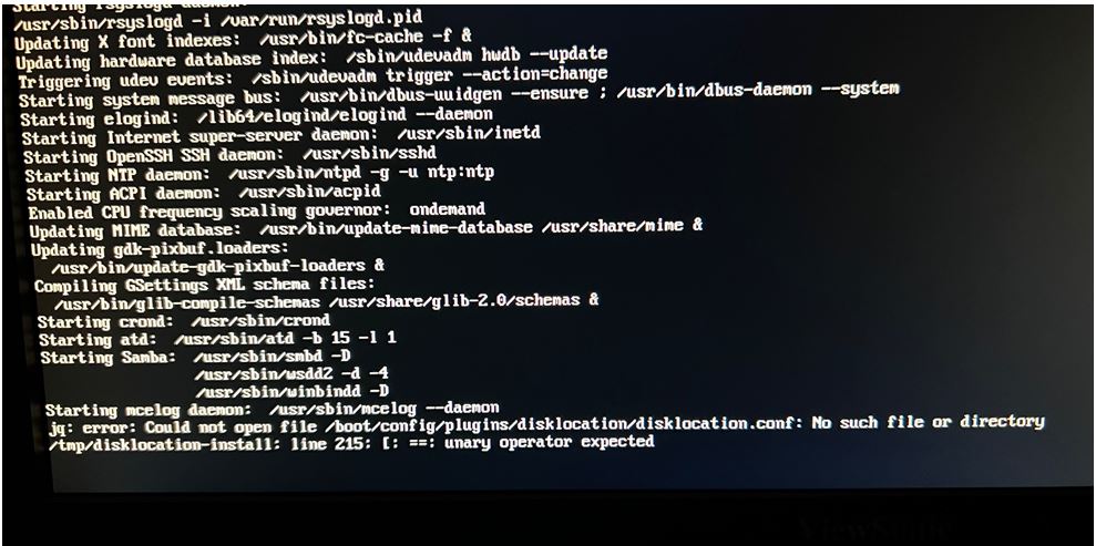

Upon rebooting, the system hang with an error message, which seems to be related to a plugin that I downloaded few days ago - disklocation plugin. Attached is the error message. I didn't really need that plugin and it can be removed if need be.
Delete config/plugins/disklocation.plg file and config/plugins/disklocation folder from your flash drive and reboot.
Thank you so much - it works. I deleted the file that you've stated and 2 disklocation folders under the config folder. Much appreciated!
