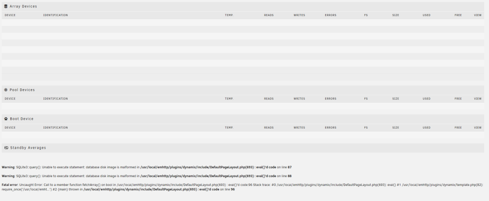

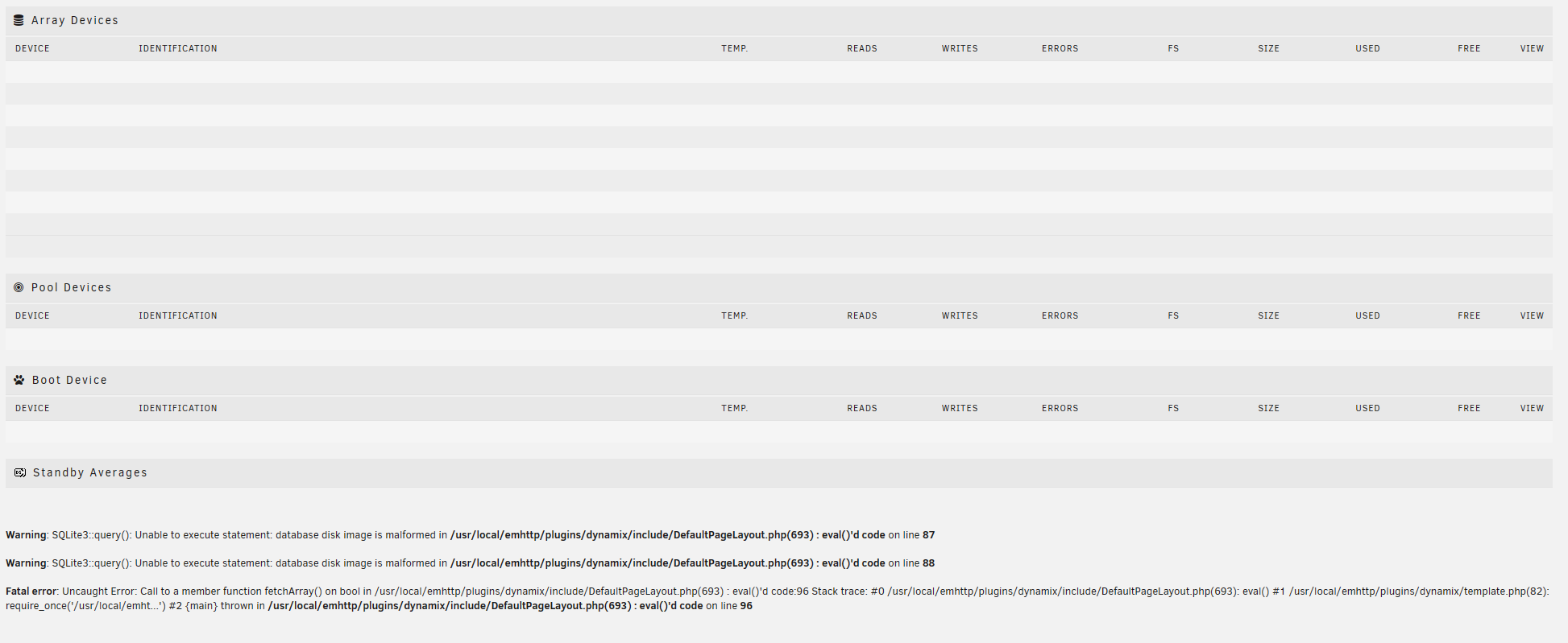

Opened up my Unraid dashboard to this one day and not sure how to fix it, not sure when it occurred exactly because I haven't opened the main page in a while, so not sure how to include logs. I tried  to search it up but couldn't find anything too relevant.
I've included a picture of my Unraid "Main" page and the error message below. I'm all ears for any ideas to what's happened and where to go from here, thank you!
Warning: SQLite3::query(): Unable to execute statement: database disk image is malformed in /usr/local/emhttp/plugins/dynamix/include/DefaultPageLayout.php(693) : eval()'d code on line 87
Warning: SQLite3::query(): Unable to execute statement: database disk image is malformed in /usr/local/emhttp/plugins/dynamix/include/DefaultPageLayout.php(693) : eval()'d code on line 88
Fatal error: Uncaught Error: Call to a member function fetchArray() on bool in /usr/local/emhttp/plugins/dynamix/include/DefaultPageLayout.php(693) : eval()'d code:96 Stack trace: #0 /usr/local/emhttp/plugins/dynamix/include/DefaultPageLayout.php(693): eval() #1 /usr/local/emhttp/plugins/dynamix/template.php(82): require_once('/usr/local/emht...') #2 {main} thrown in /usr/local/emhttp/plugins/dynamix/include/DefaultPageLayout.php(693) : eval()'d code on line 96

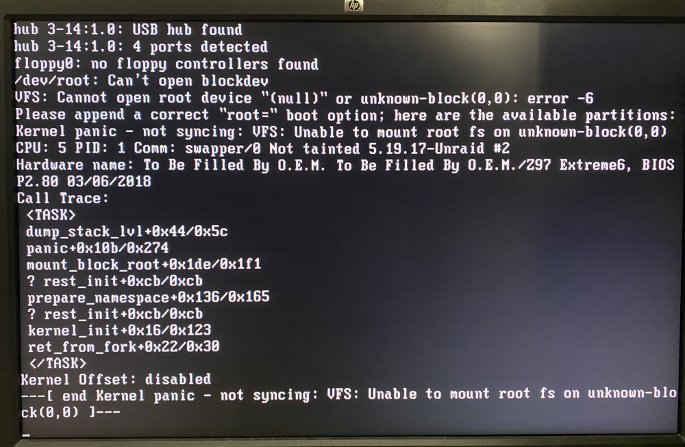

*Update: I just rebooted it and now the machine just boots to a black screen that says "SYSLINUX 6.03 EDD" and rebooted again and now says there's no boot device (should've made a backup before rebooting it smh). I unfortunately only have a Flash backup from 3 months ago so I was wondering if there's anything I could touch on the usb to fix this (but I doubt).

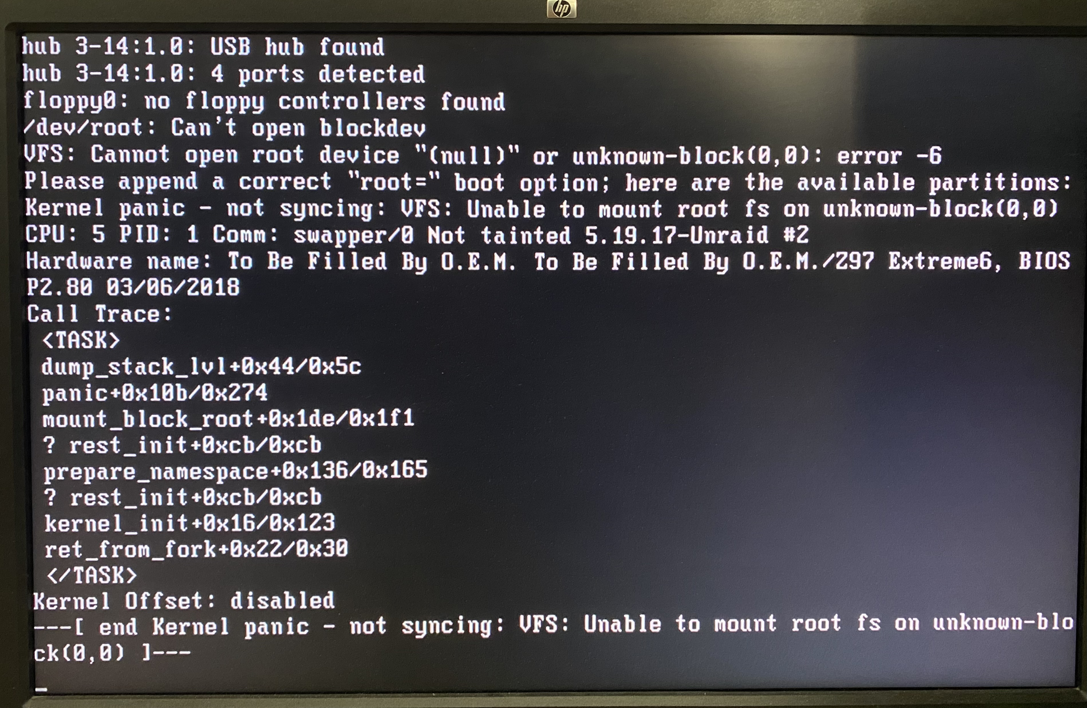

*Update 2: I haven't moved the Flash drive in months but for some reason I moved it from a USB 3.0 port to USB 2.0 and it boots but I get a kernel panic
*Update 3: Restarted it and now It finally boots again and I'm back with the main page sqlite error, I'm mainly leaving this up for others in a similar situation and also because I'm sure if I reboot it might just kernel panic again because there's something on the flash I have to change.
/dev/root: Can't open blockdev UFS: Cannot open root device "(null)" or unknown-block(0,0): error -6 Please append a correct "root=" boot option; here are the available partitions: Kernel panic not syncing: UFS: Unable to mount root fs on unknown-block(0,0) CPU: 5 PID: 1 Comm: swapper/0 Not tainted 5.19.17-Unraid #2 Hardware name: To Be Filled By O..M. To Be Filled By O.E.M./297 Extreme6, BIOS P2.80 03/06/2018 Call Trace: (TASK> dump_stack_lvl+0x44/0x5c panic+0x10b/0x274 mount_block_root+Oxide/Ox1f1 ? rest init+Oxcb/Oxcb prepare_namespace+0*136/0x165 ? rest init+Oxcb/Oxcb kernel init+0x16/0x123 ret_from _fork+0x22/0x30 </TASK> Kernel Offset: disabled --I end Kernel panic not syncing: VFS: Unable to mount root fs on unknown-blo

That looks like a flash drive problem, you can try recreating it first, if the same replace the flash drive.
Been busy so I just barely got around to it and yep that fixed it.
It let me create a flash backup on the spot and I recreated the flash using Unraid USB Creator and I finally don't get that sqlite error.
