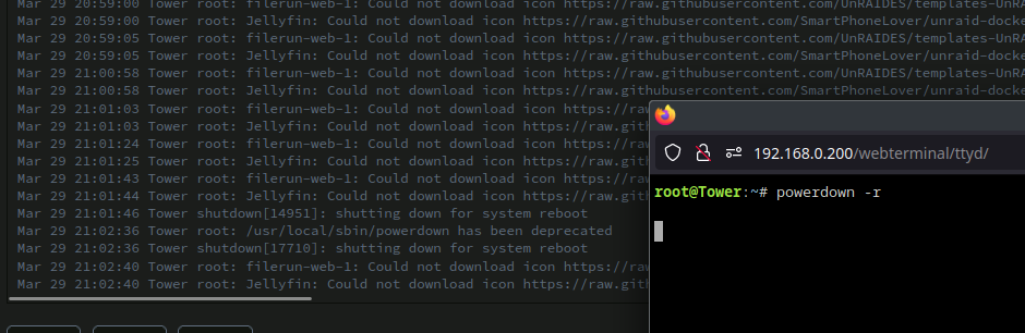

This started right after downloading and installing this update, where I was asked to reboot the server to complete the install but no matter what I tried, it just ignored both commands from UI and console.
Curiously after trying to reboot/shutdown this happens with CPU, and all dockers and VM keeps working fine.

Type reboot in the CLI.
Doesn't work
You will need to force it then.

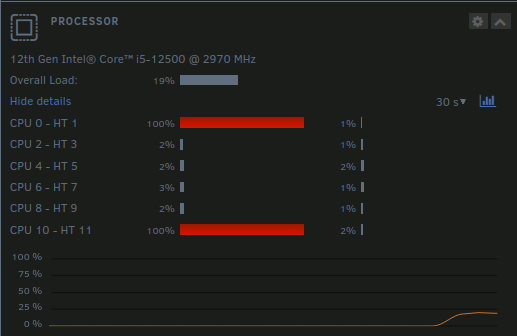

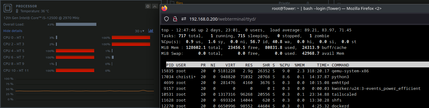

Either way, there is some things that I don't comprehend like why only some cores are at 100% even if top reports VM and python (I didn't install it) using 9%.image.thumb.png.b13c28b2439fccb14059b9c6a85ae56e.png
You did mention possible ZFS crash, but I can still access both shares through SMB and Dynamix File Manager plugin.

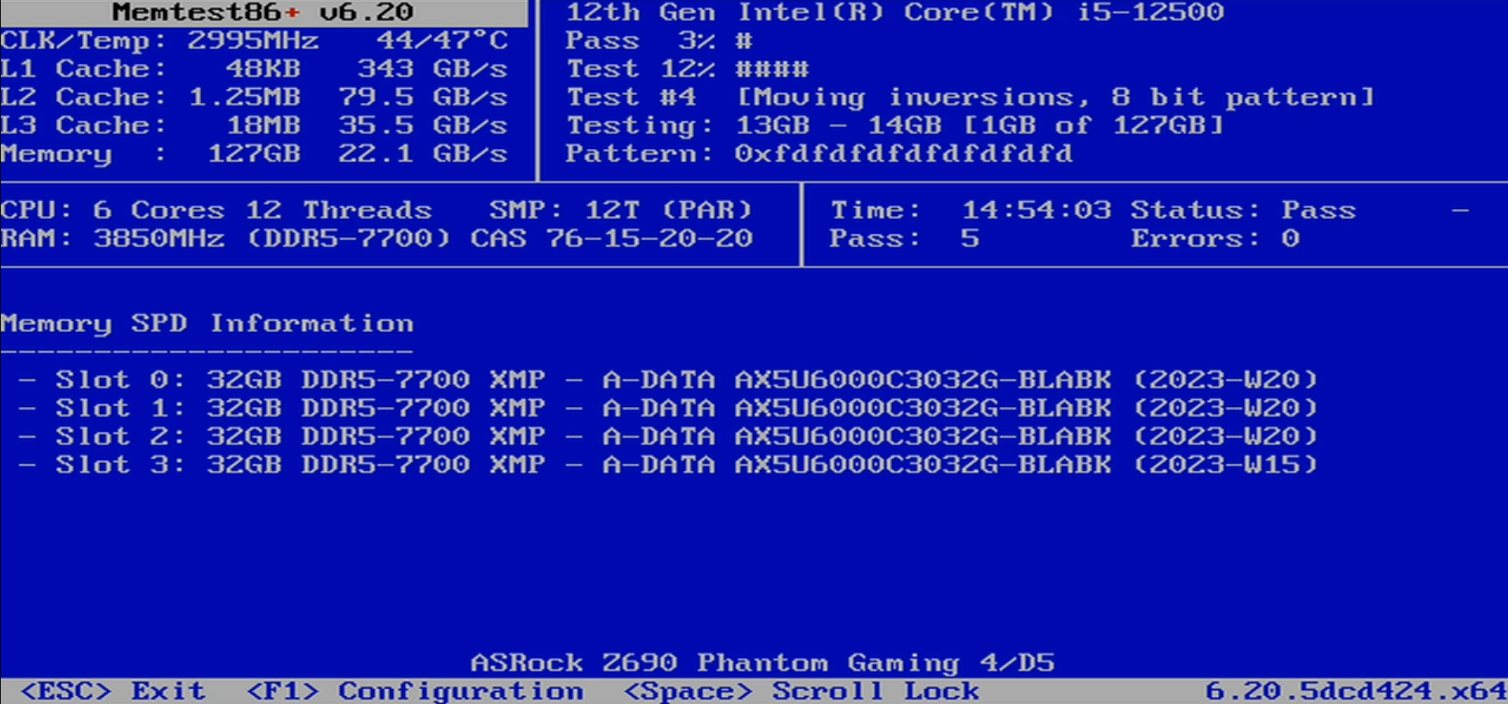

And memtest went fine (but now that I'm looking at it, wait is the memory timing at 76?)
