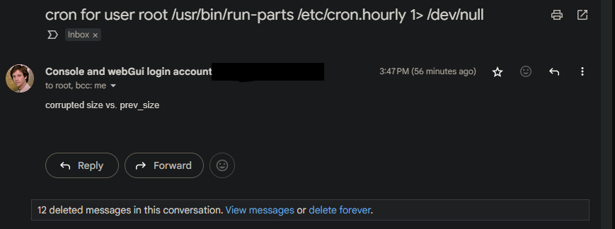

Getting cron errors after upgrade from 6.12.8 to 6.12.9
I upgraded from 6.12.8 to 6.12.9 early this morning before going to bed; after setup finished, I was able to log in and the array and all my dockers/VMs seemed to be running just fine. However, when I got up later this morning, Unraid had been sending and is still sending an email every hour indicating a cron issue:
I've looked at the scheduled cronjobs in the console, I've looked at the syslog, but I'm not seeing anything obvious; any ideas?
