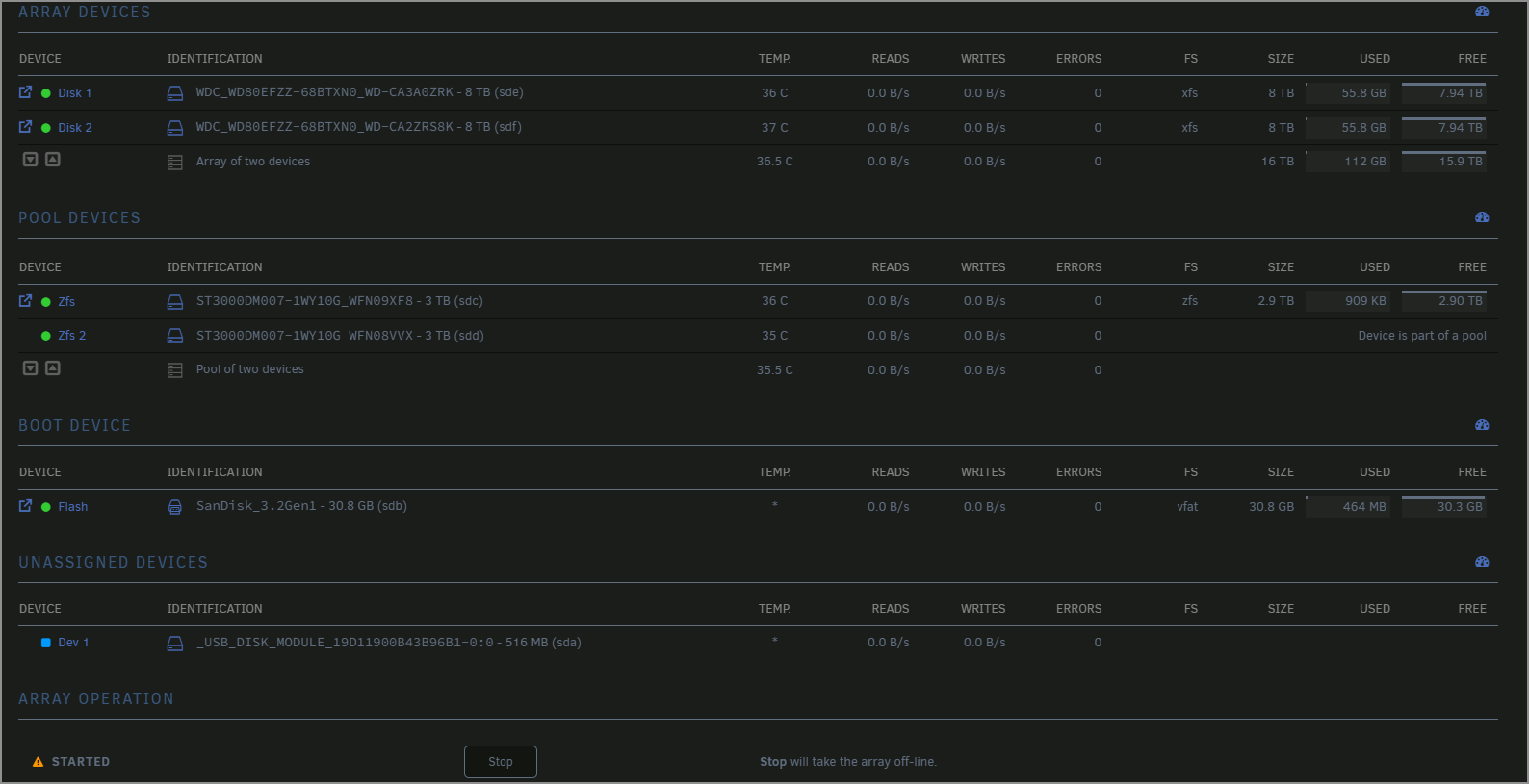

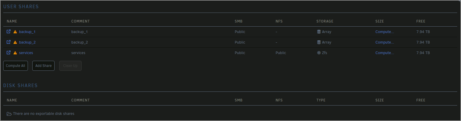

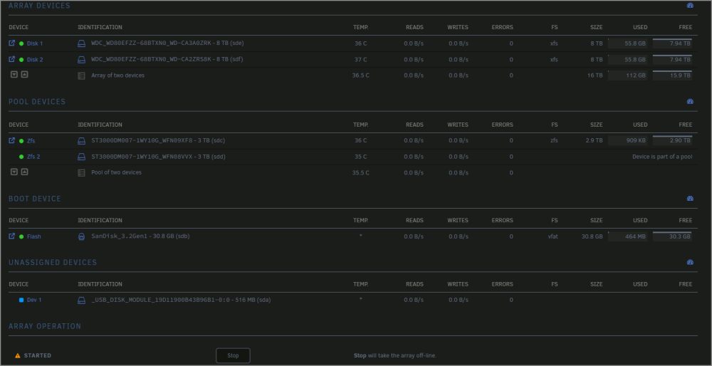

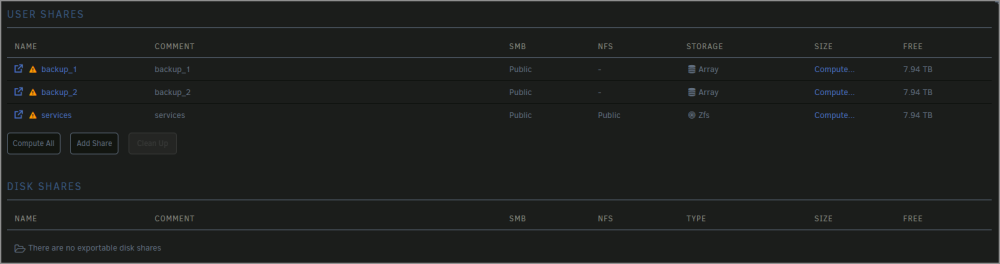

OK, I follow your suggestion and here is the result (maybe) 🙂
The warning message on backups folders should be because no parity is available (it can be deactivated?) . The amount of the service free space is wrong as well as the warning because is on RAID 1. There is something wrong I did?
Each drive in the main array is an independent file system so they are not RAID1.  You could only have them as RAID1 if they were in a pool.
The warnings about backup1 and backup2 can NOT be deactivated (at least in current Unraid releases) as without parity drives in the main array are not protected.

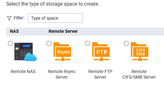

I've then installed a simply docker (axiom-data-science/rsync-server: A rsyncd/sshd server in Docker. You know, for moving files. (github.com)) with RSYNC server exposed and, finally I was able to connect to UNRAID via RSYNC from NAS.
Creted some replica jobs on QNAP and voilà (no scripting for the moment). Obviously there are still some improvements or fine tuning to do, but it works.
