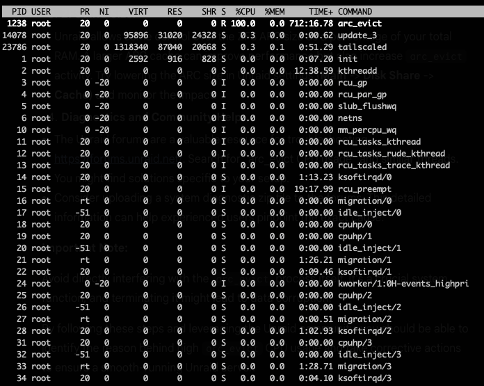

I have had this issue a few times where everything on my server stops working and the top menu shows the command `arc_evict` at 100% on the CPU. At the same time of this happening everything else appears to shutdown or at least cease to respond including the dashboard, all my docker containers, VMs, SAMBA, etc. The only thing that appears to work is ssh but sometimes that freezes up too. In the past i've been able to shutdown via ssh access or in the past had to restart physically after hours of unresponsiveness from the server.

Based on top Plex with the one using the most CPU, does it improve if you stop the container?
Yeah plex was streaming and recording live TV. I was unable to interact with the dashboard and didn't try turning it off but i'm fairly certain it was caused by the arc_evict process that stopped all containers and other processes.
I attached the ouput of the top command from when I used ssh into the system.
That's very different from the one in the diags, but don't remember arc_evict ever being an issue, so not sure what it could be

Yep, I though they were from that time, you can try enabling the syslog server and post that if it happens again, there may be some zfs related crashing/call traces.
