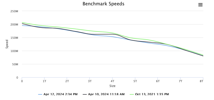

Strange about disk3 taking so much time to mount, but don't see any errors, could be a disk problem, it may not be performing normally, you can try running the diskspeed docker to test.
I did, and it all looks good... Really mysterious, these issues. I'm nervous about adding disk3 back into the shares but might have to at this point...

Could be a problem with the disk and writes, diskspeed only test reads.
