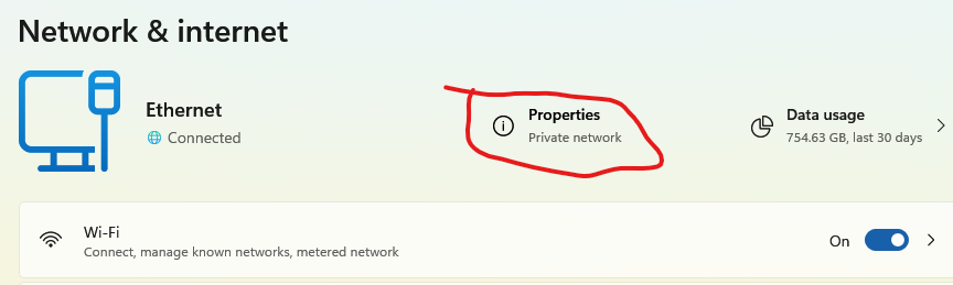

Second thing.  Make sure that your Windows 11 clients Network type is set to 'Private'.   Open   Start > Settings > Network & Internet and click here:
