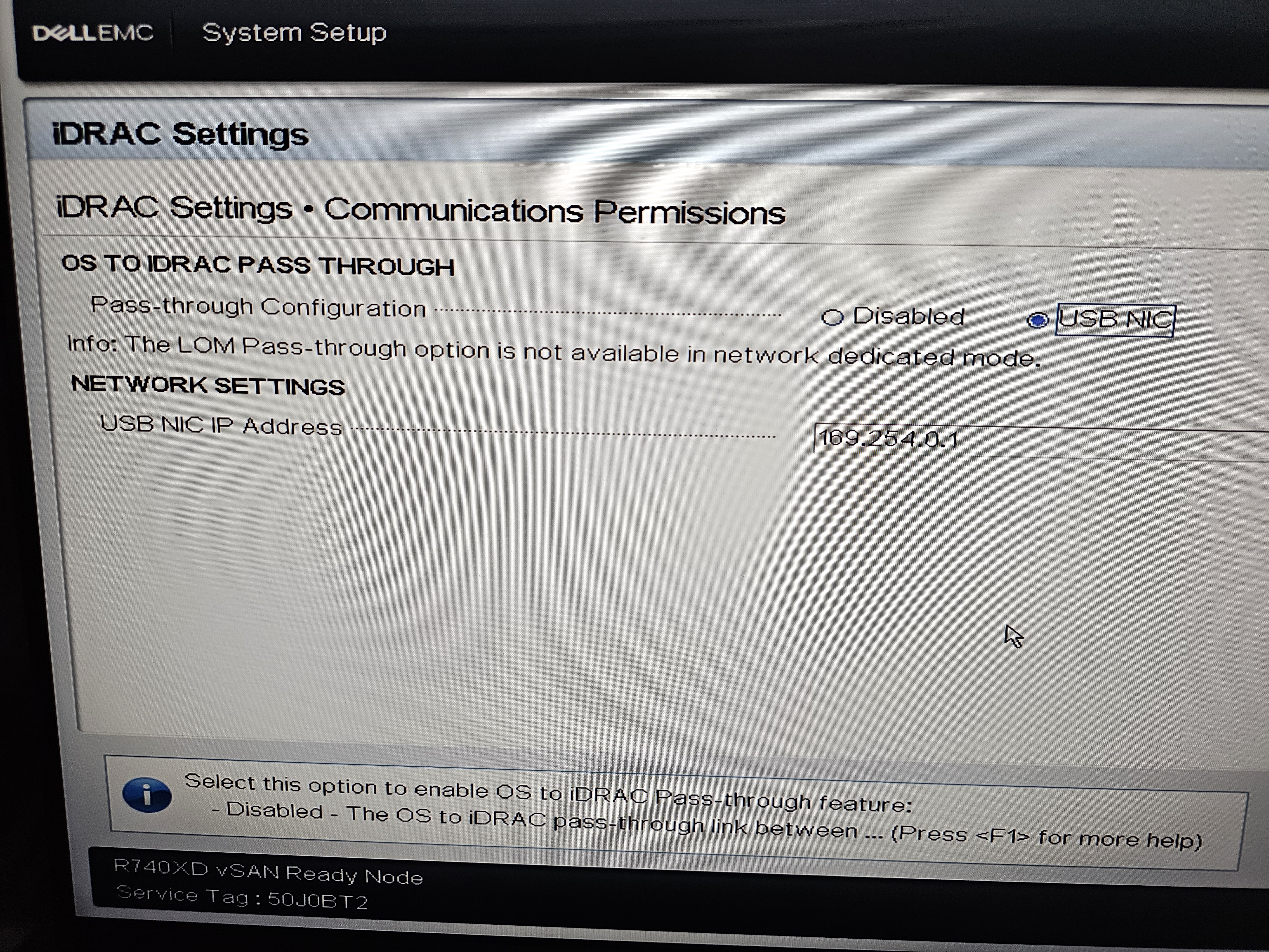

@JorgeBSo got this finally figured out.
In the Idrac Permission Setings, OS to Idrac pass through was enabled and thats where that USB NIC and ip was coming from. I disabled that option (don't really know what it does, but I don't think I need it). Everything seems to be working fine now, I can use any of the NIC ports for Unraid and Idrac dedicated port works fine as well.
