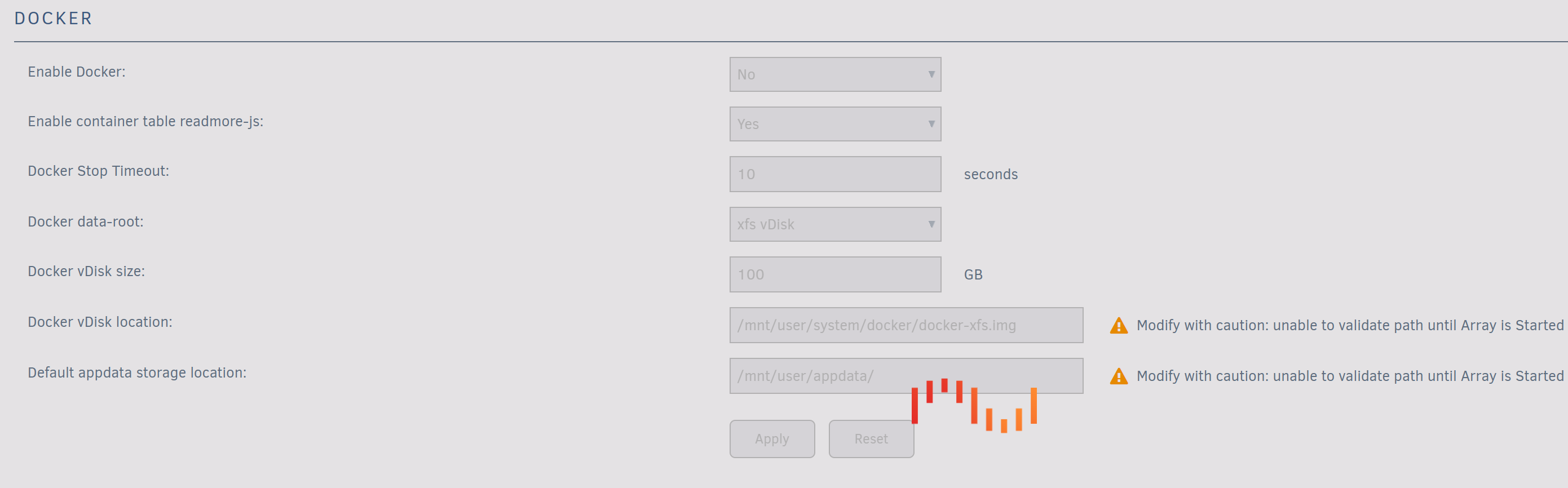

Try stopping the docker service, if that doesn't help type reboot in the CLI, if it doesn't reboot after 5 minutes you will need to force it, and make sure you are running the latest release, it may help with that issue in the future.
No luck yet with stopping Docker.  It just hangs.
Reboot to shutdown -r?  I understood shutdown -r was better (although using that can also cause an unclean shutdown in my experience).
Reboot is the same, it will try a clean shutdown first, failing that will try an unclean one, and
So I was able to start the rebuild after rebooting (safely).  It's very concerning the basic functionality doesn't work smoothly.
You need to find what's causing the cache unmount to fail, are you on v6.12.10?
Not yet.  I'm on 6.12.8.  I was going to give it a month or two.  Are you suggesting the fix below might resolve the unmount issue?
I can't see anything that gives me any indication as to why it wouldn't unmount.  It just says the containers_cache is busy.  Are you able to glean anything?  Is there somewhere else I should be looking?
