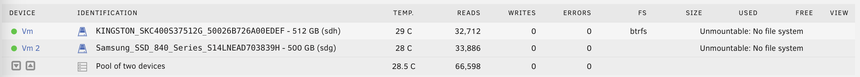

A few days ago I powered down my unraid box and installed a geforce graphics card, my thought was that I could start a new VM and try to run some games through steam link on it. While mucking around I accidentally disconnected one of the sata cables to one of my ssds in a btrfs pool of 2 that hosts all my (5) VMS. The system started as usual after the graphics card install and I thought that I was just going to let the Parity-Check go through and in the meantime I could start testing with the new VM before restarting and plugging in the ssd.
As if that wasn't enough it seems that we had some kind of power outage during the parity check and when I got the chance to plug the disconnected cable again and start unraid again both ssd devices in the pool are down.
Is there some way to recover from this?jehq-diagnostics-20240417-2109.thumb.png.150ce72ac39dc7c5063c69b24e8e6b01.png

Post the output of
btrfs fi show
7 hours ago, JorgeB said:
Post the output of
btrfs fi show

Now type
mkdir /x
mount -v /dev/sdh1 /x
If there are errors post them here

Pool is apparently OK, could be related to v6.9, unmount the pool with
umount /x
Then upgrade to v6.12.10 and post new diags after array start if it still fails to mount

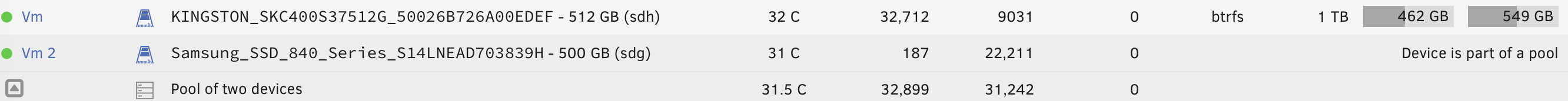

Upgrading to 6.12.10 worked.
1644648053_Screenshot2024-04-18at23_25_03.thumb.png.b2b1c1e6c1fed0dfaa99166c6c236688.png
Thank you yet again!
