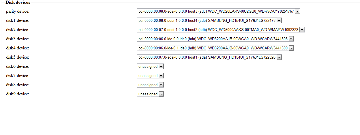

I had a disk go bad and didn't realize it (life gotten somewhat in the way of keeping tabs on my server).  I noticed when I started seeing data missing on the network shares.  Looks like the server is now seeing ther other (believed to be good) disks as Unformatted.  I've poked around on the forums and wiki a little bit and it seems like the server may have just had a problem mounting the reiserfs which is causing the drives to show up as unformated?  Kinda hoping that there's a solution here that doesn't involve losing the data on the unformatted disks.  I see on the wiki that there maybe be a way to repair the FS?  Basically just looking for some help getting pointed in the right direction on what to do.  Right now the array is stopped, server is still running, all drives are still present in same configuration.
Looking for what I should do first here.  I don't want to do the wrong thing and lose data if I don't have to.
Running build 4.5.3, posted devices screenshot and syslog.
disk2 shows up as bad.  First time I tried to start the array disk1 showed up as unformatted.  Last time I tried to start the array disk1 and disk5 showed up as unformatted.

Actually disk1 is showing as missing...I check the device page and it shows up as the correct drive (SAMSUNG_HD154UI_S1Y6J1LS722478), but on the unraid main page it shows that drive listed as the parity disk.
and the syslog says it is the wrong disk.
Hrm.  Tried rebooting again, now I'm back to disk1 showing the correct disk, but showing unformatted, and disk2 showing up as a bad disk and showing up as unformatted.

My guess is that you first need to try replacing the disk cable and power supply connectors on disk1. If that fails, then you need to move disk1 to a new SATA port.
Oddly enough, I don't see anything about disk2 after the attempt to mount it. My guess is that disk1 is stopping disk2 from working. I suspect you're running a SATA card that emulates 2 IDE controllers with 2 disks per controller. With IDE controllers, 1 bad disk on the controller can knock-out both of the disks. Knowing what SATA card you're using could help.
