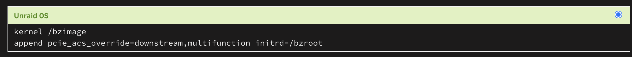

I tried your solution and the system wouldnt boot at all.
This is my current syslinux config
If it doesn't boot it's a different issue, that line won't affect booting.
