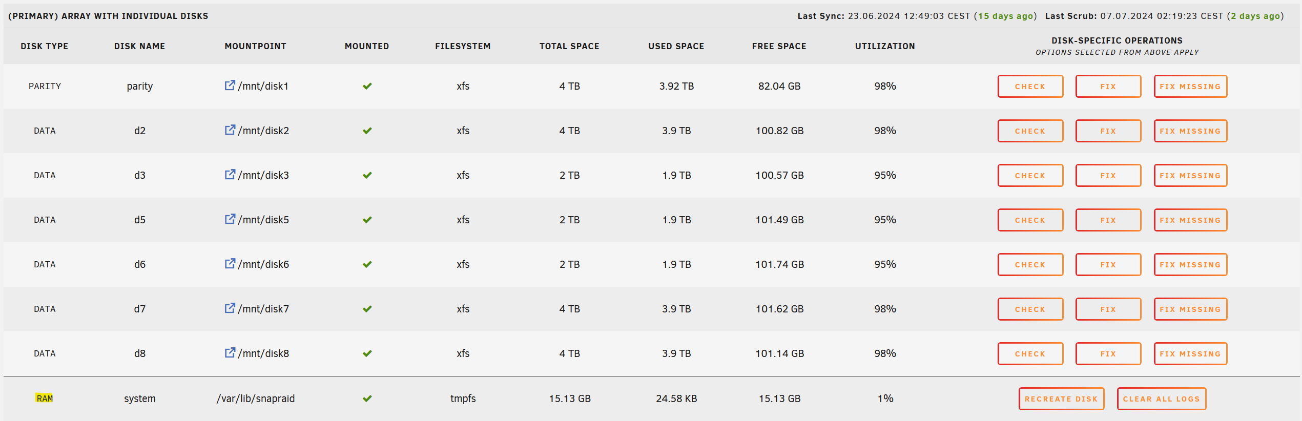

timc6896 Posted July 9 Share Posted July 9 This is great! I just set this up running 1 parity disk and 6 data disks. On the SnapRaid settings page, I can see the parity disk with filesystem of XFS. I can see the other 6 data disks but filesystem is tmpfs? Is this supposed to say XFS as well since all the data disks are formatted as XFS. Total Space for the data disks is also wrong, showing only 1.05MB instead of 12TB. When I do a sync, diff, list, etc, it does show the correct number of files and size. Other than that, everything is checking out correctly. Quote Link to comment
timc6896 Posted July 9 Share Posted July 9 13 minutes ago, timc6896 said: This is great! I just set this up running 1 parity disk and 6 data disks. On the SnapRaid settings page, I can see the parity disk with filesystem of XFS. I can see the other 6 data disks but filesystem is tmpfs? Is this supposed to say XFS as well since all the data disks are formatted as XFS. Total Space for the data disks is also wrong, showing only 1.05MB instead of 12TB. When I do a sync, diff, list, etc, it does show the correct number of files and size. Other than that, everything is checking out correctly. Please ignore this. This is supposed to be this way. Everything seems to be running Quote Link to comment
Rysz Posted July 9 Author Share Posted July 9 (edited) 4 hours ago, timc6896 said: Please ignore this. This is supposed to be this way. Everything seems to be running No problem, thanks for using the plugin - your parity and data disks should all show as XFS (see below for my primary array). 🙂 If your data disks do not show up, please make sure you used a trailing slash / at the end of the mount points ( e.g. /mnt/disk1/ ). The TMPFS disk shown at the end is the plugin's RAM disk, this is where all operational output will be written to (logfiles, etc.). It is a safeguard, so that a large amount of logfiles and/or exceptionally large logfiles cannot use up all your RAM and destabilize your operating system. The amount of total disk space shown for that disk is 30% of your total available RAM and is just the maximum possible RAM usage for the plugin, but the space is not in fact blocked when not in use. Edited July 9 by Rysz 1 Quote Link to comment
timc6896 Posted July 9 Share Posted July 9 8 hours ago, Rysz said: No problem, thanks for using the plugin - your parity and data disks should all show as XFS (see below for my primary array). 🙂 If your data disks do not show up, please make sure you used a trailing slash / at the end of the mount points ( e.g. /mnt/disk1/ ). The TMPFS disk shown at the end is the plugin's RAM disk, this is where all operational output will be written to (logfiles, etc.). It is a safeguard, so that a large amount of logfiles and/or exceptionally large logfiles cannot use up all your RAM and destabilize your operating system. The amount of total disk space shown for that disk is 30% of your total available RAM and is just the maximum possible RAM usage for the plugin, but the space is not in fact blocked when not in use. Wow! Added the trailing slash "/" and not it shows correctly! Stupid mistake on my part. I ran the maintenance cronjob and it worked as expected. No issues to report there. Also ran a rebuild by pulling out a drive and replacing with a new drive, worked 100%. This is an awesome plug-in that helps extend unRaid's limitation of a single array. 1 Quote Link to comment
Rysz Posted July 9 Author Share Posted July 9 (edited) 20 hours ago, timc6896 said: Wow! Added the trailing slash "/" and not it shows correctly! Stupid mistake on my part. I ran the maintenance cronjob and it worked as expected. No issues to report there. Also ran a rebuild by pulling out a drive and replacing with a new drive, worked 100%. This is an awesome plug-in that helps extend unRaid's limitation of a single array. Thanks for reporting back, I thought that might have been the case for you and I appreciate the feedback. To be fair, that previous limitation or rather requirement was not all that visible among the other information back then. I did address this in the latest update with some additional checks against malformed configurations, so it should be better visible in the future if something is misconfigured. That limitation itself has since also been resolved. I'm glad that everything works for you now, I've also used SnapRAID intensively on my backup server for these past few months this plugin has existed and although it does have a bit of a learning curve and some limitations, it has also worked exceptionally well for me throughout various recovery operations. 🙂 Edited July 10 by Rysz Quote Link to comment
