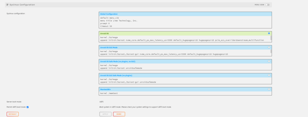

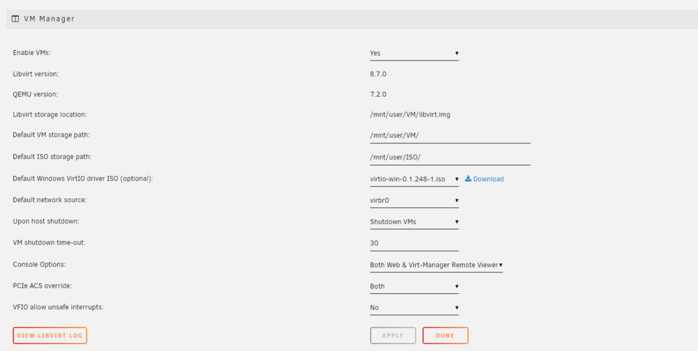

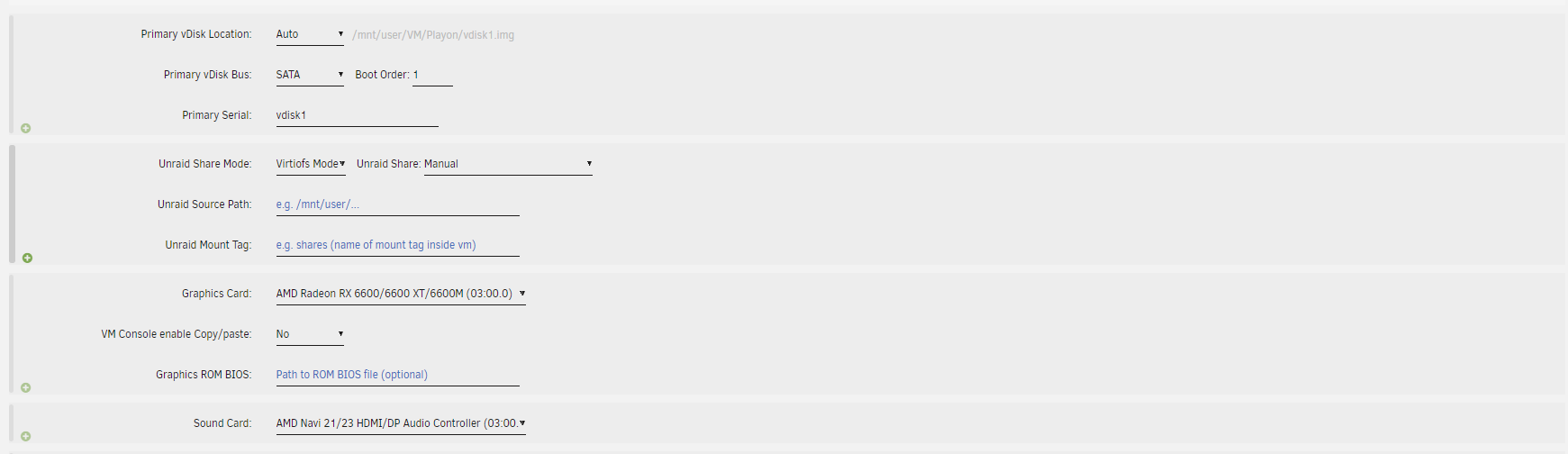

Here is the config screenshot and xml image.png.c5f0d9b21664d25fbc3a84a9d95a2302.png

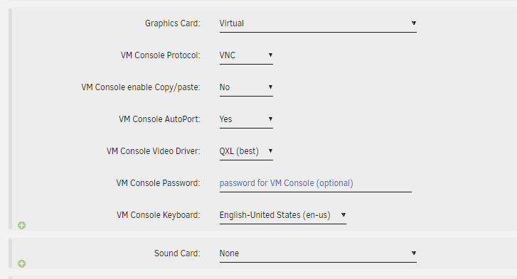

Worth noting I tested creating win10 vm with virtual disk (so no hdd passthrough and it worked)
Here is the xml for that

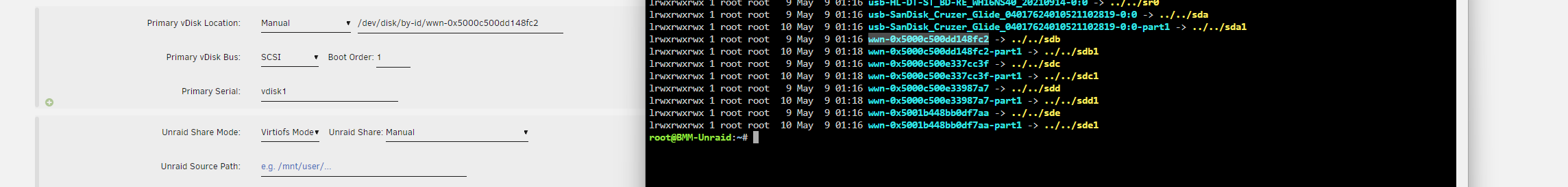

Also worth noting ssd passthrough using SeaBIOS as per other docs and vm using OVMF, not sure this matters

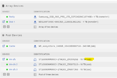

also this is ssd via data not nvme
sorry for all the updates
Edited by sully316

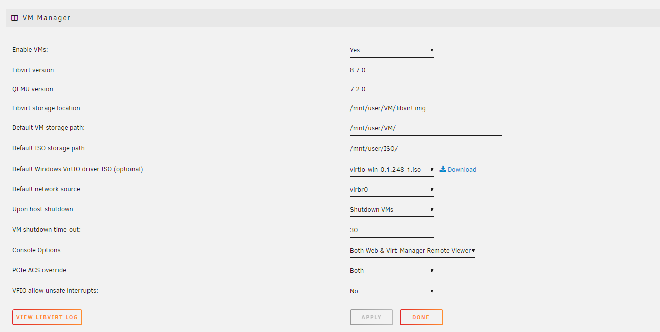

I would also recommend running the multifunction group option via vm settings.
Here is an example of my advance setting that I run for both nvidia and amd:
I recommend that you enable PCIe ACS Override and set option to both
This configures some things in unraid and sets this option to the grub boot menu:
pcie_acs_override=downstream,multifunction
It also messes with IOMMU groups layout.

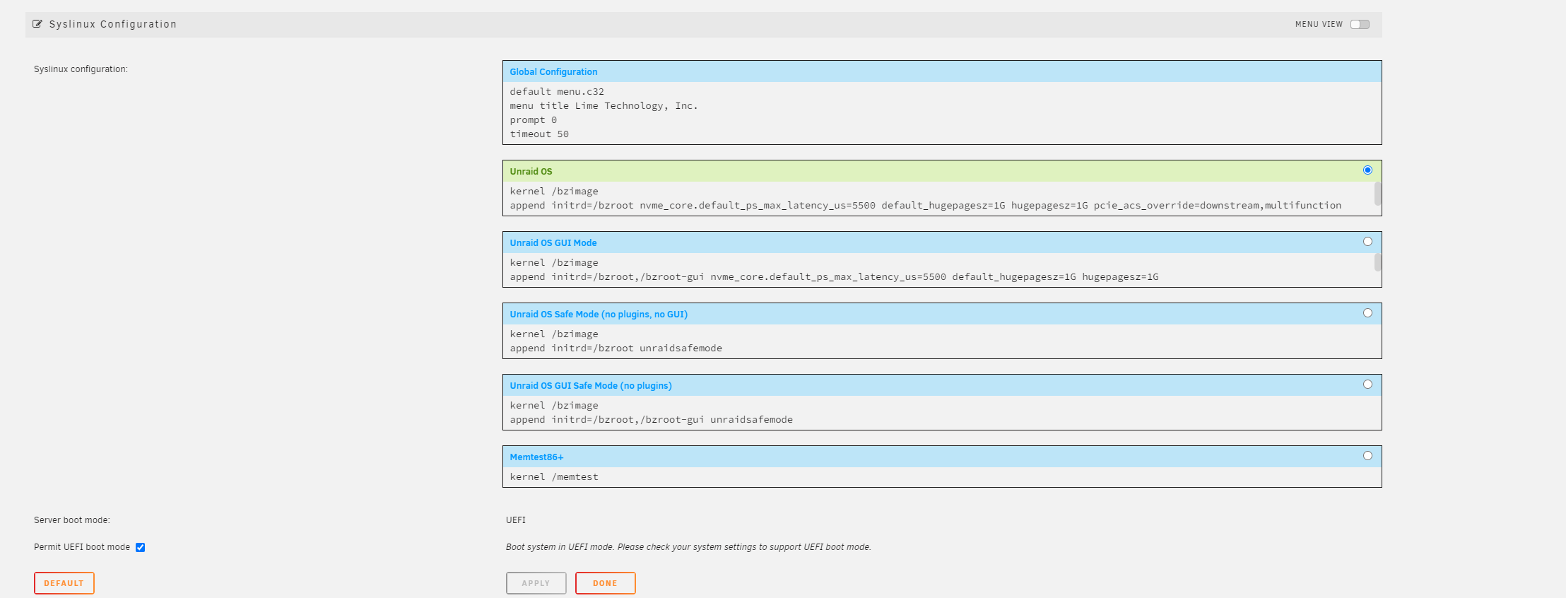

I recommend visiting the Flash drive grub options for some additional kernel parameters to help ease the G card for VM use.
/Main/Settings/Flash?name=flash
This is my recommended Grub options to assist with pcie power management and to stop FB on G-card that would prevent stubbing and make a easier transition to the VM
kernel /bzimage
append initrd=/bzroot pcie_acs_override=downstream,multifunction video=vesafb:off,efifb:off,simplefb:off,astdrmfb initcall_blacklist=sysfb_init pci=noaer pcie_aspm=off

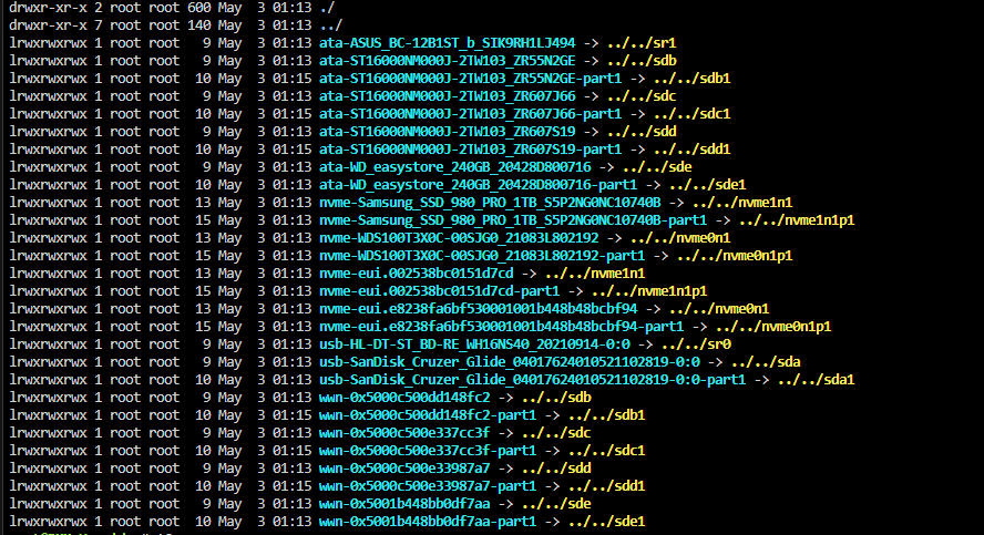

You need to fix your XML Code to pass the G-card properly. You also wish to pass a hard disk directly to the VM?
Then we will need to get the PC ID of that drive. That drive can not be in the unraid array or use with the unattended drive plugin you would see it there until we pass it by disk by ID.

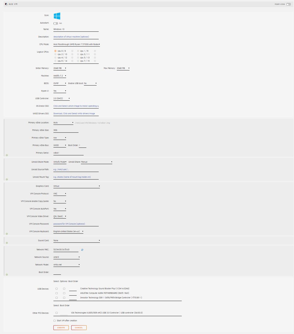

So lets review Proper VM setting and setup:
step 1 to have gpu passthrough working is to use only the PCIE G-Card.
lets create a new vm to review:
If we create a default VM no gui chagnes this is what we get:
Copy the XML code to review... As you can see this is a default Template for KVM- QUEMU for windows 10

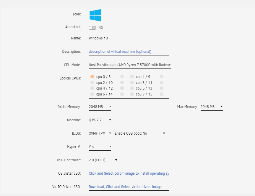

To use Windows 10 and a G-card there are some settings we want to change and take a look at.

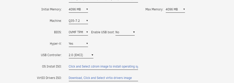

When making a VM we want to select a emulated machine type. q35 / i440fx:
It is recommended when using pcie to use the q35
The next thing we want to confirm is are we using uefi or classic bios:
are choices are OVM or Seabios:
It is recommended to use OVM as it is a UEFI bios.
Thanks to Windows 11 and Manufacture moving to firmware tpm you can also emulate a TPM with a Virtual Machine. So lets continue to make these changes via the form view to the default no options change:
So what changes in our xml? Note these options are set once at first VM creation. It is a pain to go and fix the entire XML:
so let's re-create with the correct options and choices for our VM.
Here is my recommend VM settings for windows 7 and above:

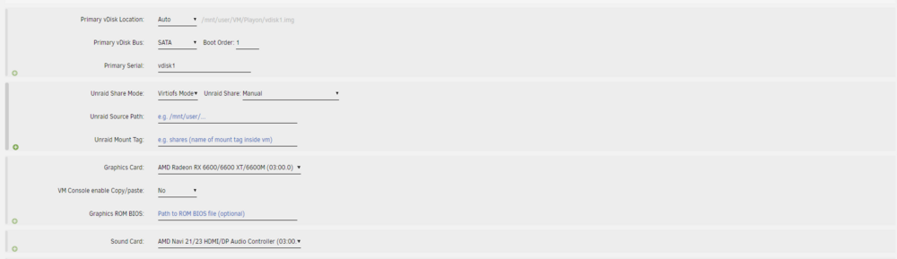

I also recommend at least 120 GB HDD if using a virtual file as a Disk
*Here is where you would use disk by id to pass a physical disk... select the disk not in use or select none, and we will add the disk latter:
Review:
https://serverfault.com/questions/896027/kvm-pass-through-disk-partition-by-label-or-uuid#:~:text=<disk type%3D'block' device%3D'disk'> <source dev%3D'/dev/disk/by-id/ata-Corsair_CSSD-F120GB2_1109650632000461003B' /> <target dev%3D'hdc' bus%3D'virtio' /> </disk>
To get you disk by id:
ls -la /dev/disk/by-id/
Example output:

This way you have a base installation with a VNC qemu virtual display. Note under VMS you will see:
VNC auto for virtual display or the G-card you pass when done correctly!

Awesome. Its easier to pass a disk to vm at first vm creation.
will give you all your partitions and disk id #
in my case, I want to pass my 16TB disk as example
it is seen as /dev/sdb
I then compared my disk ID by physical Linux path /dev/sdb:
Not I have other partitions on this i don't want the part i want the full disk!
lrwxrwxrwx 1 root root   9 May  9 01:16 wwn-0x5000c500dd148fc2 -> ../../sdb
lrwxrwxrwx 1 root root  10 May  9 01:18 wwn-0x5000c500dd148fc2-part1 -> ../../sdb1
So my disk passthorugh by id code is:
/dev/disk/by-id/wwn-0x5000c500dd148fc2
at disk selection in VM Click manual.
The disk can not be used for unraid what so ever!
if its is a pool device, you will break many things!
you would want to see it under:
but not in use with the unsigned device plugin. As the VM will take if from VM host.
XML code:
    <disk type='block' device='disk'>
      <source dev='/dev/disk/by-id/wwn-0x5000c500dd148fc2'/>
      <target dev='hdc' bus='scsi'/>
      <serial>vdisk1</serial>
      <boot order='1'/>
      <address type='drive' controller='0' bus='0' target='0' unit='2'/>
    </disk>
